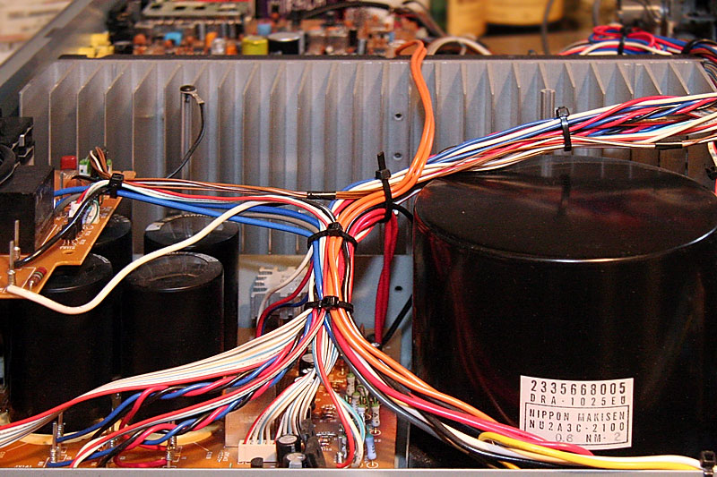

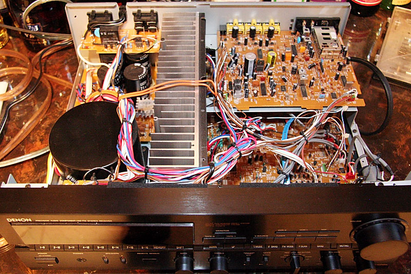

Super Member
I recently scored a Denon DRA 1025RA at the Goodwill. I am quite partial to Denon, and this must have been their TOTL or at least second in command in the early 90s. It's 125wpc receiver, and very nicely built.
The catch is that one channel doesn't work properly, ie it is very quiet with absolutely no base. There are probably no mids either and even the highs might be somewhat short of whats required. The right channel sounds fine. I've tested the unit with three different pairs of speakers as speaker pair A and B, and the problem is consistent on the left channel of the receiver. I've also blasted a good amount of Deoxit into all the pots I could get hold of (especially balance and volume, but found no improvement.
I would be grateful for any speculation what might be the issue, and how difficult it might be to fix. In the end I will probably give it to somebody so get it fixed rather than attempt a DIY, since I am a dead loss with a solder iron :dunno:

Nice looking receiver, Frank! I need to go to your Goodwill Store! The problem is going to be either a bad speaker relay or a bad cap in the feedback circuit in the amp. Both are very common problems.
