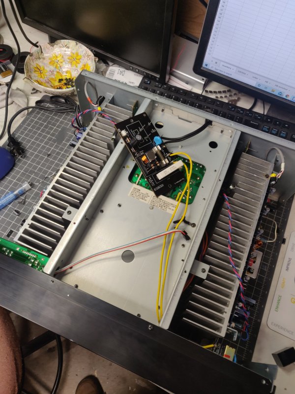

When the gremlin finally emerged, it was in the form of a mechanical rattling sound, almost certainly a relay flutter. Which relay, since there are three in the unit? The symptom continued when I turned off both sets of outputs, so it had to be the protection relay.
Hard to tell from the service manual, but it's found under the bottom cover.
If a relay is staying closed but not maintaining continuity through the switch contacts, it makes sense to replace it or maybe you can get away with cleaning the contacts. But if it isn't staying closed, the relay is not usually at fault. When I repaired televisions in a previous career, it was de rigueur to find and replace a driver transistor and flyback diode (in this case TR102 and D205), because it often worked and because the parts were cheap and almost always on hand: you just needed a general purpose NPN transistor and rectifier diode. I replaced those, and C205 at the same time just because it was a 30+ year old electrolytic. None of the parts measured bad, but with an intermittent symptom you don't always expect that anyway. Looked for bad solder around the relay coil legs, didn't find any, but resoldered there anyway.
The symptom was now improved but didn't quite go away. Instead of rapid fluttering, you'd just get random isolated clicks every few minutes. So I included some 5v zener diodes in my next Mouser order, and when D206 got replaced, the symptom went away entirely. I suspect D206 and C205 were responsible together.

Thank you very much @duncan for this post. I am in progress of solving similar "relay flutter" in my POA-2400.
Tracked it to the same board under to bottom cover, wanted to start with relay itself and with the C205 cap. Now I have nice confirmation and parts list for replacement. :)

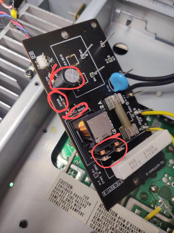

Have finished my unit today. Following was done:
- replaced 220uF capacitor
- replaced 5V zener diode
- replaced 2.2 (4.7 for EU) ohm 10W resistor (somebody was in there before me and changed it for two 80's stock 6W resistors in parallel resulting in higher resistance than the one noted in schematic)
It looks stable and the problem did not returned so far. In case it returns I will change also the transistor with the other diode.
UPDATE: Well there was reason why the resistors were in parallel, the in rush current kills the single 10W resistor pretty easily. The 10W resistor mentioned in the schematics was something special or a typo. So much to improving things that work o_O.
UPDATE 1: For Europe it should be 4.7 ohm 10W resistor (R101)
So the whole story is that there were two 5.5 ohm resistors in parallel from previous repair which equals 2.75 ohm which kind of mislead me and I confirmed the 2.2 value for myself from service manual, but did not read the "fine print" describing differences between regions.
So the correct value should be 4.7 ohm.

My modified poa-2200 was also experiencing random relay clicking. I replaced the circled items, and cleaned the relay contacts with deoxit and a paper towel. Listened to it for an hour earlier today, no clicking. I'll update in a while as to whether the issue comes back. I measured the cap, and it was significantly out of spec. I replaced with a higher voltage rated unit, same capacitance value.
Update. No more clicking. Several hours of operation now with no clicking. If this does not solve the problem, you may have an issue upstream at the +-25v power supply, check the rectifier diodes, the filter cap (1000uf 35v in my case). Alternately, any of the protection circuits also shut off this relay when triggered, but then your amp would not be making sound so doesn't really apply in this particular condition.
