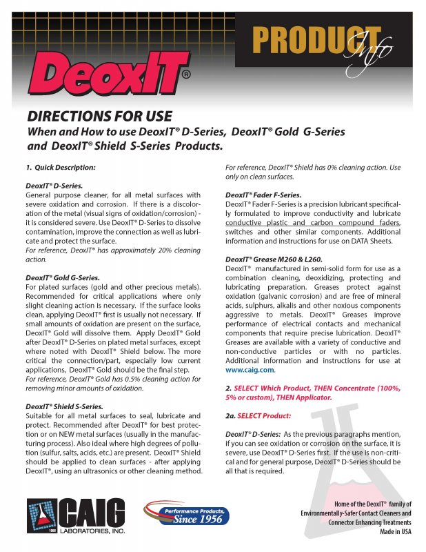

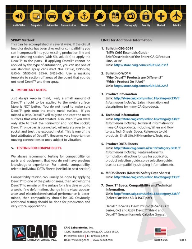

Not 100% sure if this is the right place to post a DeoxIT guide like this.
We would like to post more guides like this, hopefully it will help to give better understanding about DeoxIT and other CAIG products.
If there's a better place to post it, please feel free to let us know. Thank you!
To download the pdf file of this document, please go to:
http://store.caig.com/s.nl/sc.18/category.238/.f
