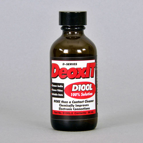

I would recommend D100 + Fader F5. D5 and Gold are more for newer equipment. D100 works much better on old equipment since most of it used silver and silver will tarnish black over time and it's very hard to remove. Fader offers more protection than Gold and again it works better on old equipment. I posted a picture of how bad a 40 year old switch can get which is why I'm part of the take apart and clean if you can group. Also, if you are dissassembling the unit, any of the liquid versions are better than the spray version (more precise and less mess).

Yes, they come in a small tube and they also come in a glass bottle (and several sized in between). The bottles, which is what I use, are 118ml and the small tubes are 2cc. I apply them with a syringe or a lint free swab depending on application. I would recommend getting Deoxit 100, Fader and Shield.
