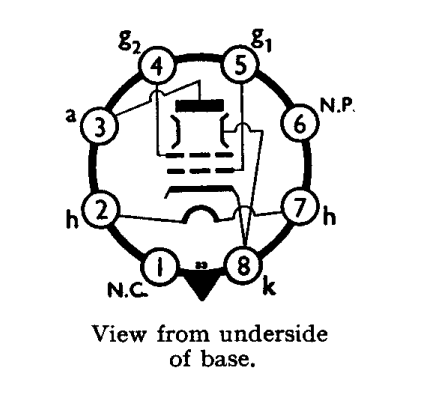

Heyo,
I'm working with 5U4 rectifier tube, and I'm getting close to 100v AC on the rectifier heaters. With no tubes I'm getting 3.5v on the power and pre-amp tubes, but the rectifier, is way out of spec from the 5v I believe I should be getting.

What are you measuring? Measuring across pins 8 and 2 of the 5U4 you should read 5VAC or thereabouts. 100VAC and the 5U4 would be dead as a doornail, the filaments completely blown.
Take all the tubes out, turn on the power and measure the AC voltage across pins 8 and 2 of the 5U4, and across pins 2 and 7 of the KT88. You should get 5VAC on the 5U4 sockets and 6.3VAC on the KT88 socket. Might be higher due to over-voltage but you should get something close.
AC voltage on pins 2 & 8 of the 5U4 rectifier should be 5 volts.
With directly heated tube rectifiers, you get the high voltage off of one leg of the 5V of the rectifier tube.

Keep checking, something's miswired. The ECC99 is drawing a huge amount of current and burning up the plate resistor. How are you using the ECC99? One half per channel as in the schematic? Make sure the cathode bypass capacitor(s) are oriented properly. Check the input grids and make sure they measure 100K to ground. And not to get too simplistic, but make sure you're reading the pinout chart correctly. The pins are arranged the way you would see them as you look at the bottom of the socket. Sorry, just thought I'd mention it.
