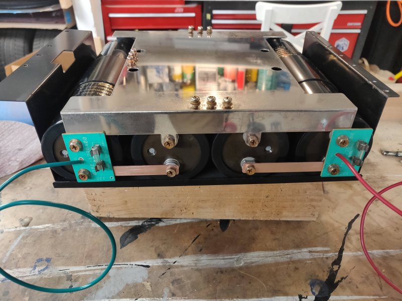

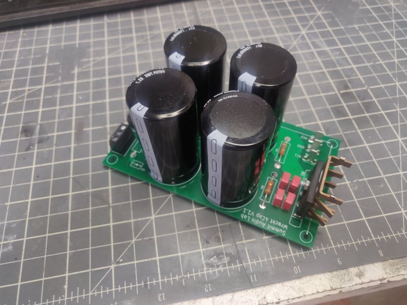

Been doing a bunch of work to my gb150d amp. It is built into an old Rotel 1052 receiver. I setup the a new 2x20 vfd display that is controlled by an Arduino nano. The Arduino also controls the 4 input relay board I got on eBay. I recently designed my own power supply pcb to replace the hacked arcam power supply. It provides +-55v rails, and 48000uf of filter capacitance. It has bleeder resistors and led indicators with an option for snubbers at the output.

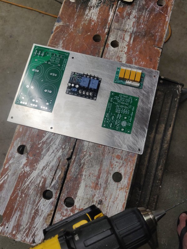

My mounting panel was too small, so I made a new larger panel that will help me accommodate a custom buffer pcb that will ensure any source can drive the amp.
Gotta build out the buffer board and test it. It has an integrated power supply, and is based on apt holman buffer circuit.
A fleabay DC speaker protection board is used.

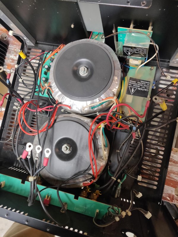

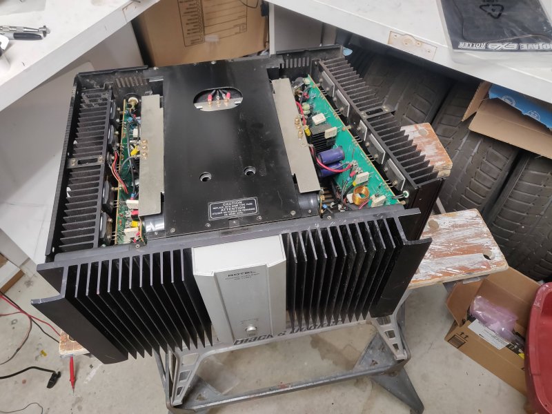

Another project that I wrapped up this summer. A rotel rb-1090 power amp that was going into protection when I got it. Sucker is HEAVY. Something like 90lbs. Heavy. It has dual 1.25kv transformers. It had a blown output transistor, and the first batch of replacements I found were fakes, amp lasted 5 minutes. pop. Sat around for months, finally found some other sankens, they were real. Bought from a better seller than some clown on fleabay. Amp repair successful. I cleaned up the ground plate, all capacitors, copper bars, etc.... Amp sounds great, and has TONS of power. More than my speakers need. Interestingly, it plays very well at low volumes as well. Pretty pleased with it.
