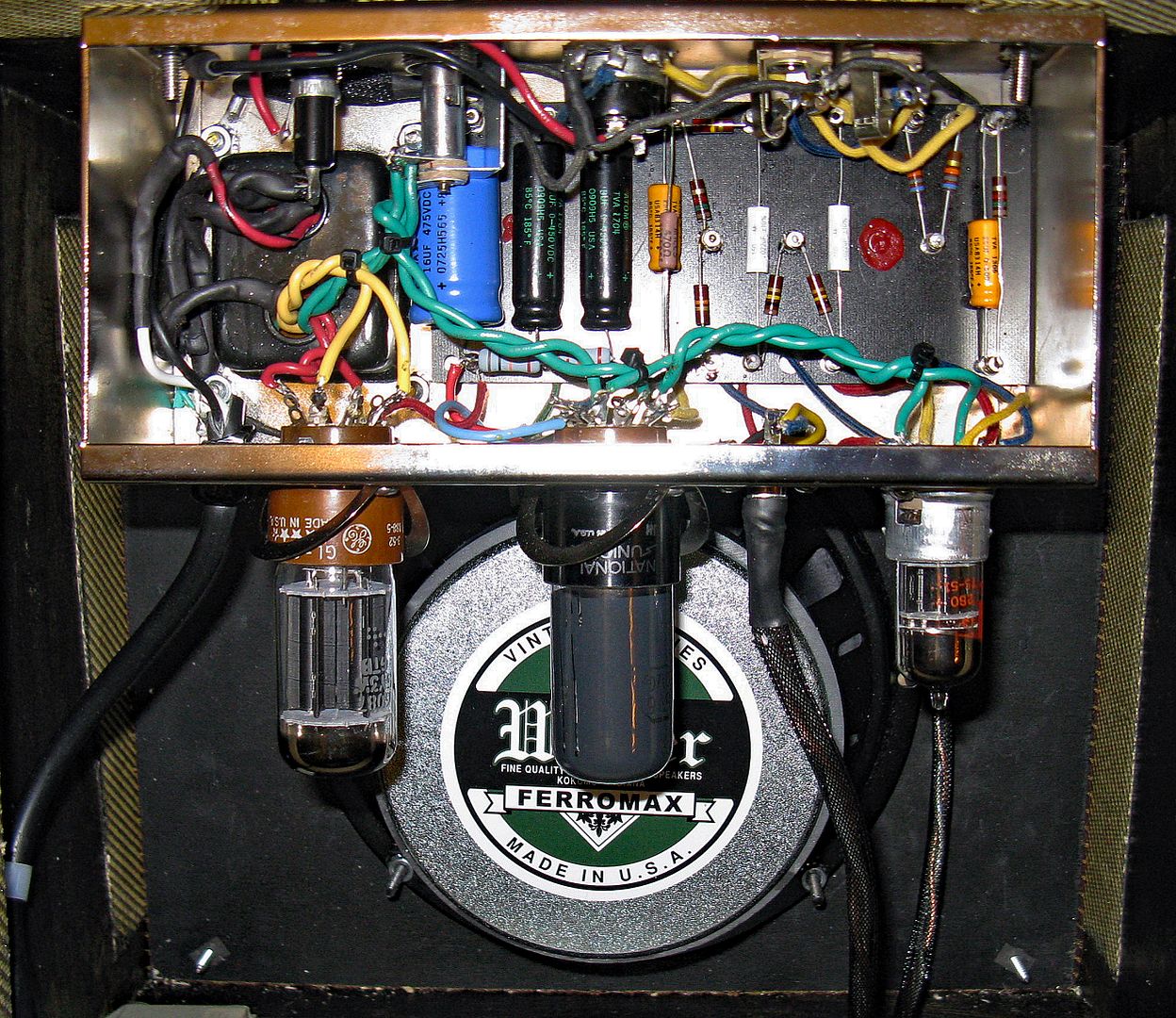

You can use point-to-point wiring or a breadboard (or turret board). You don't really need a circuit board (PCB).

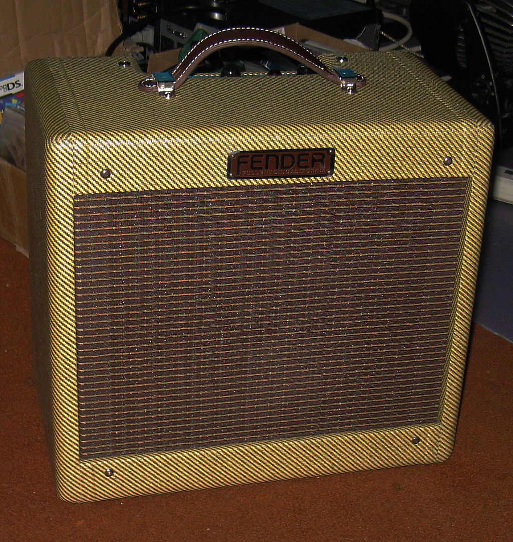

My DIY 5F1 Champ kit. I followed Rob Robinette's page.
The 5F1 uses a 12AX7 in the front end.
Open Rob Robinette's page for details..
The 5F1 is pretty simple to build using just the schematic. I used a piece of eyelet board I had on hand. It's even easier since the layout drawing is easy to find for download.
