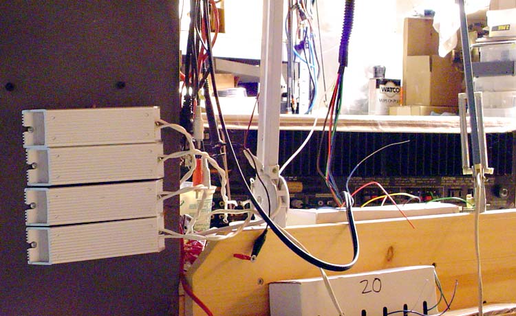

Why not just wire up a couple and use them whenever doing maintenance? I use 16 ohm loads so that I can measure the output power, but as was mentioned above, anything below 100 ohms would work fine.

You need to load tube amps, and you need to provide a PROPER matching load. I suppose you could take a chance using the transformers, but have the fire extinguisher handy ...
Good dummies aren't all that expensive and a good investment. Only suggestion there is to provide plenty of heat sink as they can get hot ... mine are mounted to an old furnace chassis that I've converted to shelving ... plenty of mass for most anything I can throw at them.
** I work with quad btw, which explains why I need four of em ...
