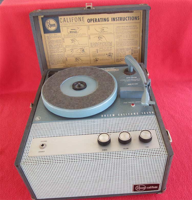

Or you could get one of these ...
Cartridge output is almost a full volt, but the 6-8 gram tracking might be a bit rough on your "special" records. <G>
