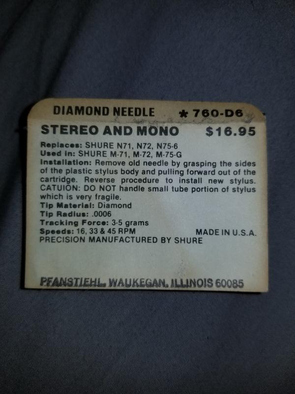

My DUAL 1015 has the M75 Type D cartridge.
I wanted to buy a new needle and I found that this cartridge has the stylus ”DN 325 (N71 M-B) 0.6 mil spherical diamond” according to https://www.vinylengine.com/library/dual/m75.shtml
I found a compatible stylus called „N75-6 Shure” in one of local stores (I wrote compatible because that was written in the N75-6 specs). I ordered it, it came, I insert it in the cartridge but I remembered I never set the tracking force on my DUAL. That was a big slap over my face I took.
I started to read DUAL's manual and the info of the cartridge and I found that my cartridge has a stylus pressure: 2.5g (2 to 3g).
I started to balance the tonearm (having tracking force and anti skating set to zero).
After I found the balance for the tone arm, I started to put weight on the tonearm by rotating the little wheel situated on the counterweight and use a digital scale to reach 2,5 g.
I managed to do that, BUT AFTER I screw that little wheel to LOCK it, the tracking force is not 2,5 g anymore. It is bigger like 2,64 g.
I was very careful when I screw it in to lock it, not to touch or rotate it. Where do I do the wrong? What can I do to fix this?
Later edit:
I followed manual more carefully and the tracking force does not modify after tightening the screw. Phew!
Everything is OK with the tracking force.
The only problem that remains is IF the N75-6 styus I bought was a good choice or not or if the tracking force of 2,5 g is suitable for that stylus.
Thank you!
