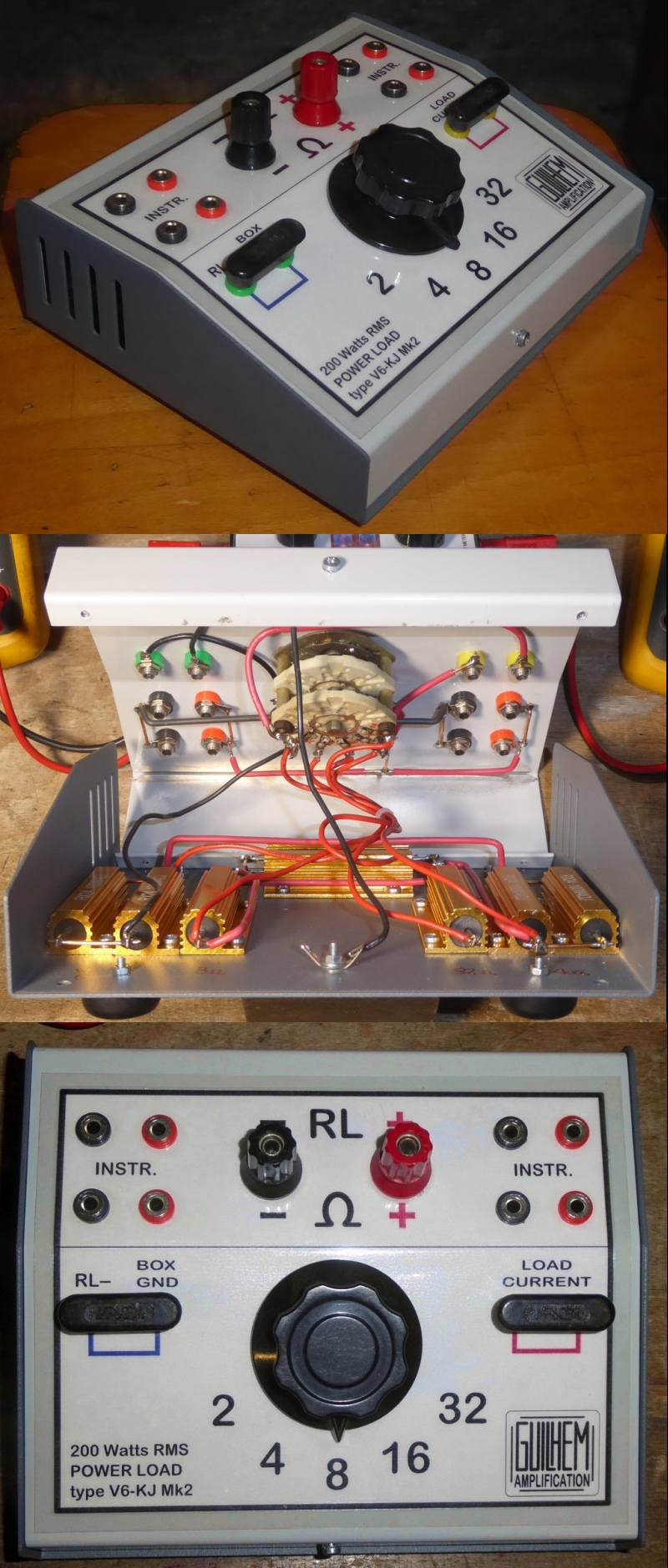

That's really cool looking. Can you share close up photos of this with the lid open?
My DIY dummy load, type V6-KJ Mk.2 - the steatite rotary switch has 4 paralleled section, so the contacts are quadrupled...
Successor of the V6-KJ (Mk.1)...
In action :
I think you were referring to my simple build. The banana plugs on the cable has an attachment for another banana plug that can be used to connect to Ocilloscope or multimeter. I have light foam around the dummy load heat sink for now to hold it. So far hasn't gotten hot enough to worry about. Later will do a more permanent attachment for the heat sink to the box and remove the foam. The dummy loads have thermal compound between it and heat sink. PXL_20260507_230835468.jpgPXL_20260507_230840980.jpgPXL_20260507_230924988.jpg
