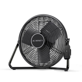

I built this filter system out of extruded aluminum for the frame, like what's used in 3D printers. I almost never have to dust for several months with 4 - MERV 13 16x25x1 filters. The house HVAC uses MERV 10. It runs 24x7 on a medium speed. When cleaning records I just wheel it into the kitchen an hour or two prior the starting
Filters
I used this Infinity Fan.
I used Shapr3D to create the 3D model.
This YouTuber shows how to make the same filter I have, but for far less cost. He hot glues the filters to each other, no frame needed. He also compares the Infinity fan to a box fan for noise.
IMO, @Indy33 is on to something there. HEPA filters are overkill for dust. You need two things: adequate filtration, which can be accomplished with MERV 8 or 11 filters, and air changes per hour. No matter what filter you use, if you are not changing the air through the filters no filter will work well. Those units you posted simply do not move enough air, nor do they do it efficiently. Remember, moving air creates noise, too.
Sorry for the delay, I've been out of town for a week.
This fan can can do the following in a 15 z 15 x 8 ft or 1800 cfm room
Using high speed as an example ...
(1040 x 60) / 1800 = 34.3 times / hour room turnover
I would be interested in a better fan with better air flow and efficiency. Can you suggest another fan?
I thought AC Infinity fan were considered a quality product, but maybe not. I run the fan 24/7 on a Medium speed. Then I just turn if off when listening.When recording or cleaning I run it High.
Did you watch the video, he compared the Infinity fan to a box fan and it was considerably quieter.
