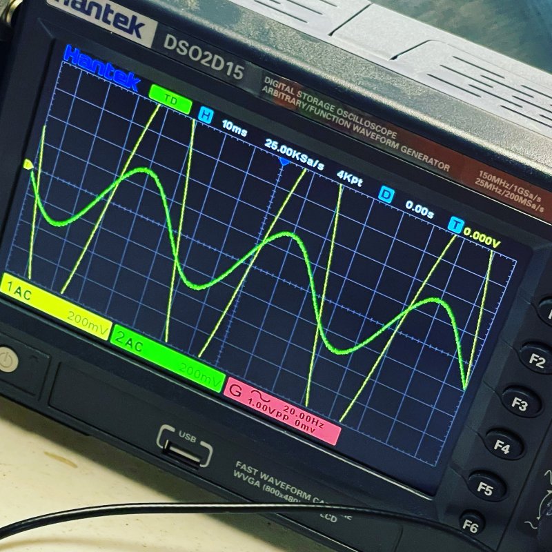

I just want to note, I was wrong about the problem being in the phono section. I hooked up a scope and realized the problem existed in the line stage as well, it just wasn't as easy to reproduce. The left channel has way too much low frequency gain as shown by the picture above. I temporarily bypassed the tone controls (using the PAS 3x neutral implementation), and that seemed to resolve the problem. Today I'm going to take a harder look at the tone controls

It is a picture of my scope showing the amplitude of the left channel at 20hz vs the right channel. Not sure why you can't see it. As much as I love the content on AK, the software running the site is getting long in the tooth.
Assuming your PAS 2 is in stock form other than the power supply board, check to make sure the 62K resistors on the PC-5 board are in place and measure correctly. These are required to properly load the bass pots for flat response when set to center. Without them, there would be about 10dB boost at 20Hz. If you take a resistance measurement at the output jacks you should see about 50K ohms, considering that there is also a 510K and the bass pot in parallel with the 62K.

I’m not sure if it is my problem, but both 62k resistors measure under 50k. I don’t have any 62k resistors here, but I’m surprised left isn’t significantly lower than right.
Values under 62K would result in a loss of low end response and above 62K a boost, with the bass pots at center. If the 62K resistor had been the problem, the one for the left channel would have been significantly higher than 62K. Thus, the resistors themselves are likely not the cause of your particular problem, but you may want to follow the traces from each end of the 62K on the left channel to check for broken traces, or a bad solder joint on the PCB. Check for a 50K ohm reading right at the related end of the bass pot to ground. Since bypassing the tone controls fixes the problem, it would seem a problem exists somewhere in the bass control circuitry for the left channel.
