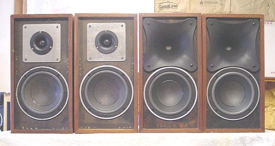

Good. I've got a pair of cute little Cerwin-Vega D-1's, with tweeters that I don't particularly like, that are in for something of a shock. And if their cute little (newly refoamed) 8-inch woofers don't measure up, they're in for yet another shock that may include some Dayton woofs suggested by Herr Newman. :yes:
Hey Paratima, I have always like the bass sound of the CV and think they will make a great Ewave project. Post in the Ewave thread, pics of your project. Cheers.
which of your ar-4x creations do you think came out the best? I have 3 pairs!!!!!! would like to try it!
The pair on the right! I'm more than a little biased though...
