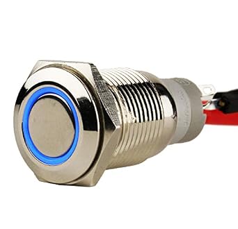

I've been rolling with push buttons here ...
The LED annular ring is kinda neat, and comes in assorted voltages you should be able to match to an available tap in the amp.
Kinda slick. Where did you get them? Mouser?
Amazon!
I wondered about quality for $10, but I've got a couple that have gone through a LOT of cycles ... good positive action on them.
Here's one mounted on a custom build ... I drive the light at lower voltage so it's dimmer than usual, but I like it like that.

Amazon!
How did you wire it since it has 5 pins and no tech data for the push button at all ?
