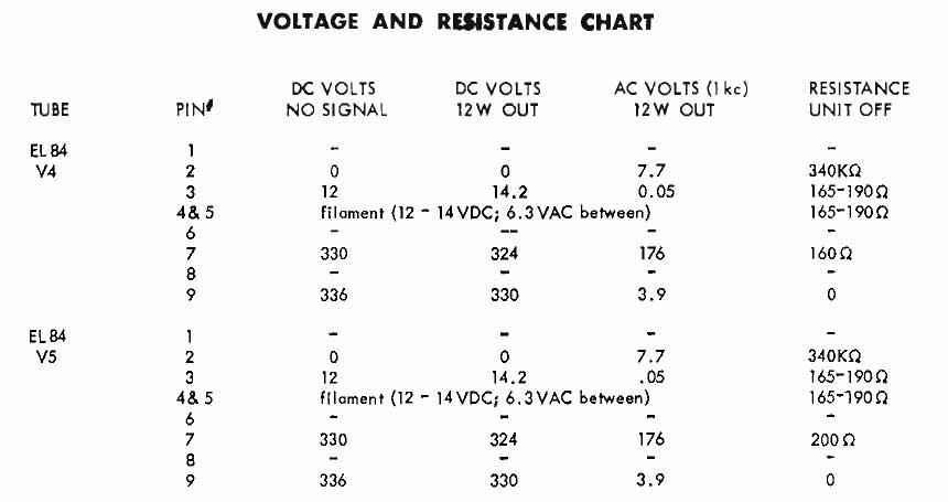

What's the screen voltage on that guy?

Good question, if it's not UL I'd put a 3 dollar SS screen regulator in it. 6BQ5s with regulated screens can be a wonderful thing.
Another neet feature on the amp ... you can still find information on it!
Got me a nice tasty copy of the original build manual with all the test voltages, troubleshooting, and evarthang!!
PS ... I'm thinking an SV83 would get pushed pretty hard in this rig, and not all that sure it'd be stable in this configuration. As mentioned earlier, these lil beasties do NOT like to be modded.

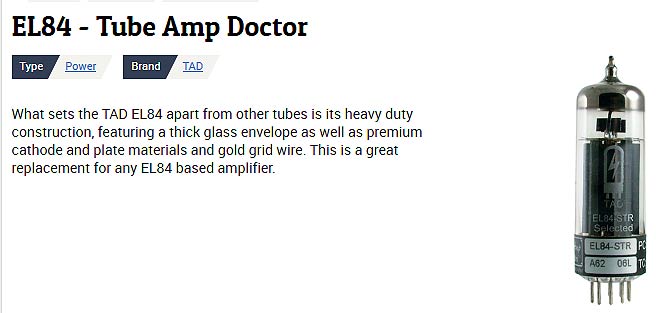

Well ... just pulled the trigger and went with these.
The biggest issue with these amps is microphonics, and these get great reviews for that. The Sovtek is also spiral wound - highly recommended in the first stage. It shouldn't have any issues with the required tube shield either, unlike the TAD 7025's - those have thick glass and could be a tight fit.
The 7025-WA's are supposed to be a 12AX7 on steroids ... higher gain with a full midrange and smooth top to bottom. Guess I'll see.
And ya ... yall talked me into the TAD power tubes. If nothing else all the exposed logos will match! ;-}

7025 indicates spiral filament low noise tube, the "W" is for vibration resistant, and the "A" is controlled warm up time (11 seconds). Gain should be same as 12AX7.
Yes, transistor regulator, I'll post the schematic soon as I can find it, it's on my other computer. It works great, and can be built adjustable or fixed voltage out. And the voltage out is super clean, a great spot to take your phono voltage from too. I use a 1N4007 diode at the take off when I do that.
So, did I do good?
On the regulator, be interesting to see if it's something that would be easily reversed if necessary. I'm a bit wary about damaging the iron ... the PT on these things is apparently some serious weirdness and almost impossible to find replacements for. I may just err on the side of caution there.
PS ... I still expect the Sovtek was a good choice in the shielded socket, as the TADs do have that thicker glass that can be a tight squeeze ...

Yeah ... like TAD's a brand, eh. <G>
From what I understand, they're built by Shuguang to TAD's specs, and TAD also does final QC and selection before branding them. It's the little design tweaks that make them special.
Nothing new really ... even RCA sourced out half their catalog.
Fun fact ... the standard EL84 is 20mm diameter. The EL84STR is 22.5 mm. Internal envelope is the same ... The difference is in the glass.
