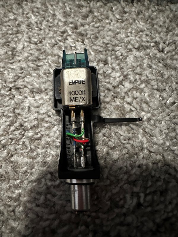

Hey everyone! I want to thank you for all of your super helpful posts. I’ve been a lurker here for years. First time poster because I’m very confused about a seemingly obscure Empire cartridge I’ve run into. From my research, I’ve seen many similar model carts but none identical to this, besides ONE eBay listing.
The cartridge is marked Empire 1000ii ME/X
The stylus appears original and is transparent green. It sounds incredible, honestly. I just want to make sure I can get a high quality spec replacement stylus. Will a generic stylus for empire 1000/2000 work? I don’t want one if it will sacrifice sound quality or tracking.. But just don’t know what to match it with on lpgear or what have you

I was reading about that as something to do for Empire carts. I do indeed have a multimeter and am capable of doing that. Is there even any hard and fast rule for what TE/x, ME/x and SE/x even mean? Other than the x supposedly being a higher spec or something?

Well... That is a head scratcher. That looks absolutely nothing like mine LOL
Wow! Thanks for that photo. Head-scratcher indeed. I've seen Empire re-use a handful of model names, but never shave the difference so close. Well, get at least a resistance reading off the channels and we'll know what family your cartridge belongs to.

You may be right. I'm getting 530 ohms resistance on each channel. Which indicates a 66 style body probably? No means of measuring inductance currently.
In the 500ish ohms range, definitely a 66. You can use just about any stylus from this generation ("Blobs", since we couldn't come up with a better name for the body shape). The worst that will happen with a mismatch is strictly a frequency response error in the upper two octaves, and there are various ways of dealing with that.
