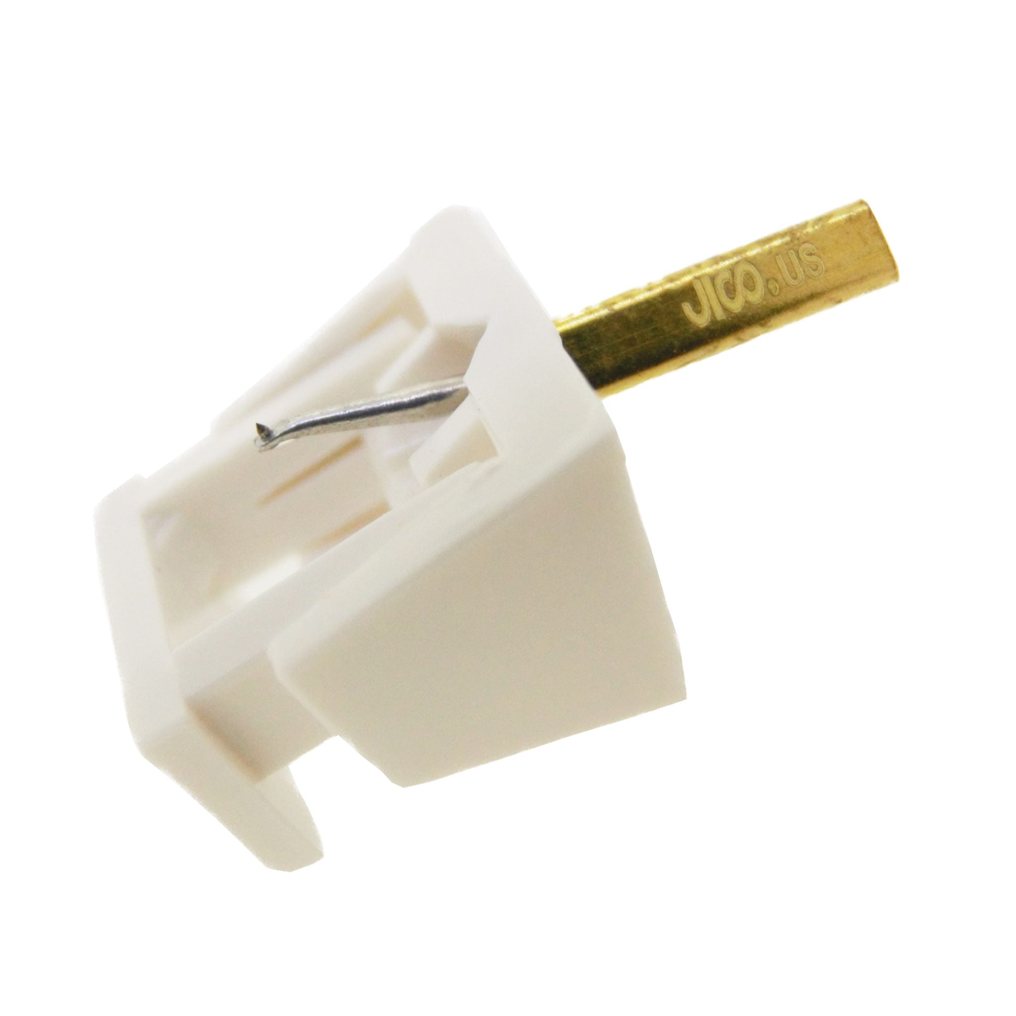

I inherited an Empire 598/II turntable a few years ago and now it seems the stylus has started to wear out as the sound has deteriorated. The cartridge is an Empire 4000 D/I and the stylus is pictured here. Can anyone ID the stylus and or tell me where to find a replacement? Thank you!

Correct stylus for the 4000 D/I
Not going to find an original for money you would spend. Maybe there are some aftermarket styli.
It also can be retipped assuming the suspension and cantilever are in good shape. Additionally, the 4000 can use any of the 2000-series styli except those for the 2000Z and 2000T (those have smaller shanks).
