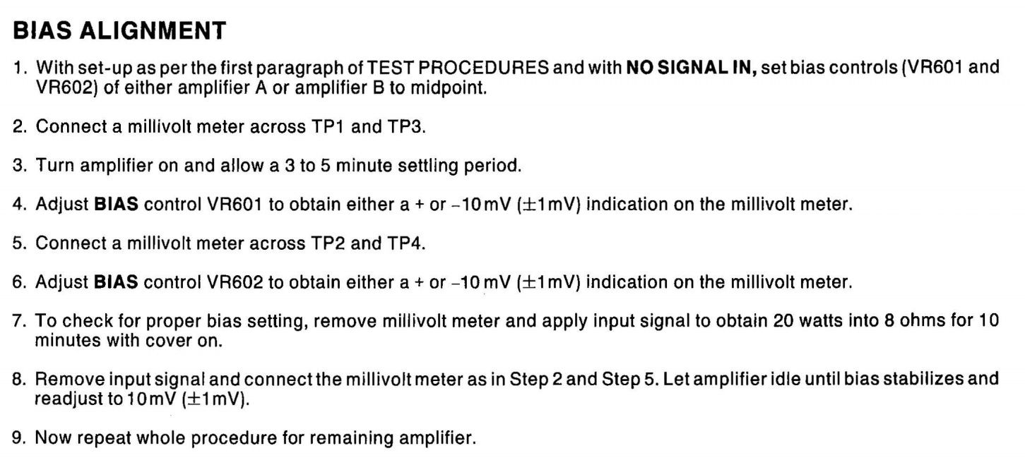

It seems from service manual there is only bias adjustment for his amp (idle current)

FYI... the bias adjustments given above are for the GFA-535II. Service manual for the GFA-535 says to connect the Positive lead to TP1 and Negative lead to TP2 after warming up the heat syncs. For each channel, adjust VR601 to achieve 5mv (+/- .5mv).
