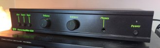

I got someone to make some stickers (decals) for me on eBay, I've resprayed it and I'm just waiting for the new knobs. It's my first attempt so please ignore any mistakes! I finished this last night...
