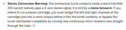

2nd question might be harder to answer since the 202 tonearm seems to be pretty rare. You can have 3 different cartridges at the same time by spinning it around. It currently only has an xp3 cartridge which also seems pretty scarce. The wiring has been pulled out of the tonearm so im trying to figure how it’s supposed to be wired without the wires getting wrapped around the shaft that holds all the carts as you turn it.

Here is what AI says about how the three cartridges are switched.
I’ve never seen that arm before.
