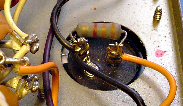

Another trick you might like. Automotive windshield caulk - that black rope stuff - makes a nice gasket compound for fitting new smaller caps into an old bracket. Just roll it to approximately the right size and press it in place. Press hard around the clamp, and it cuts the excess off neatly. Bottom right corner for an example ...
And ya ... you CAN usually find caps with the same diameter as the originals, but sometimes they just look plain weird. The main rail caps on this one were originally four times the height.
