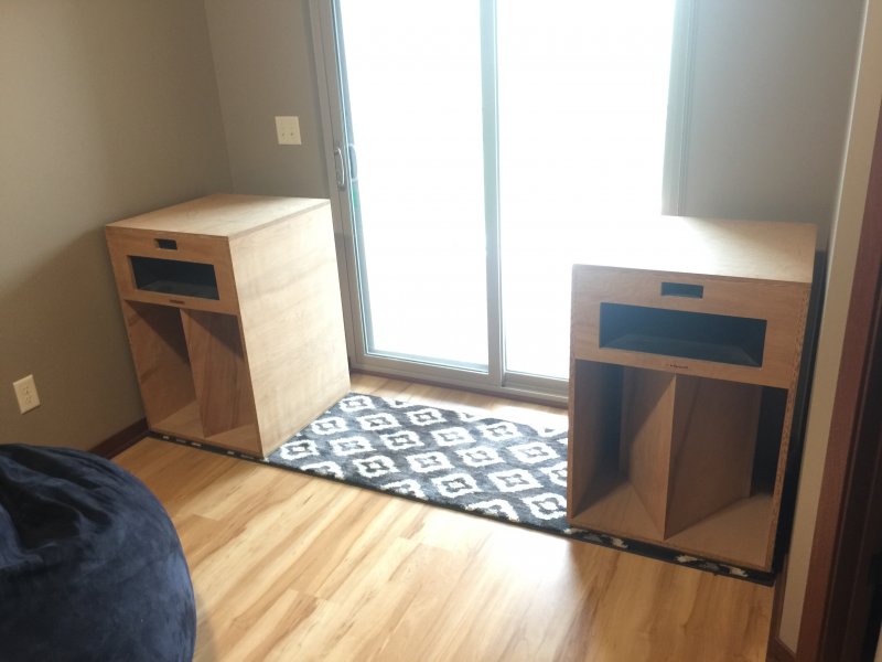

Just picked up my first ever Klipsch heritage speakers! Found an excellent pair of original La Scala. In great shape overall, just needing some cleaning inside and out. The raw birch is interesting and unique. I plan on leaving the unfinished wood as-is, since it adds character. I am rebuilding a Fisher 800c to pair with these. I somehow ended up owning 4 tube receivers that aren't finished yet, so a buddy brought over his Mcintosh 2505 and it sounded great! I will have to move stuff around to find a good spot for them, but oh well.

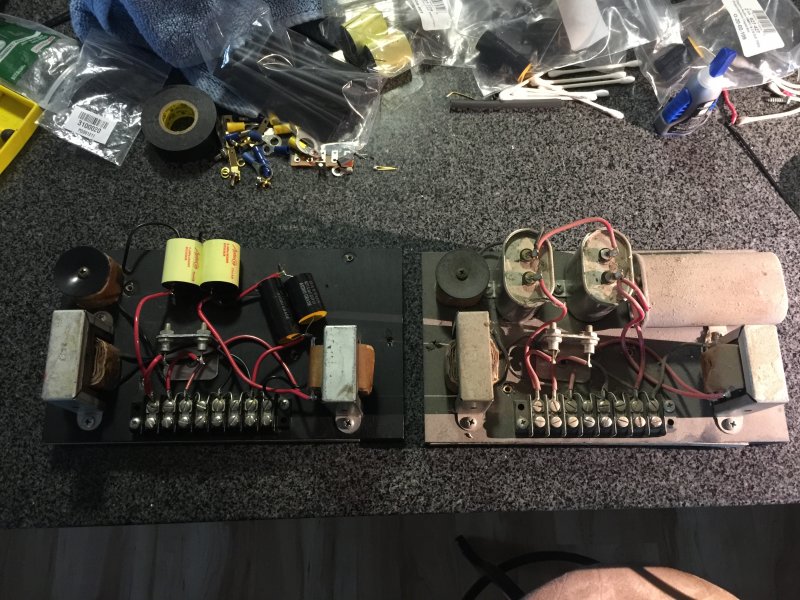

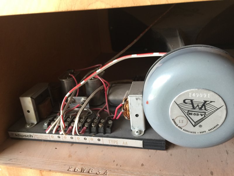

I have no idea if recapping the crossovers will result in a change I can hear, but that is next on the list. I'd rather not have a large oil can leak after using speakers that have been dormant for over a decade. Ordering some Audiocap PPT Theta's for the 2uf units and combining some cheaper Daytons to make up a 13uf (probably 6.2 and 6.8uf).

Congrats! They are excellent speakers and the crossover upgrade does help if you have the older AL type crossover. Mine were not leaking but they were old and the change improved clarity to my ears. Have mine connected to MC30s, love them!
Keep those old caps.
I did a cap "upgrade" (crites) on my Cornwalls. I had listened to them for about 2 months before doing this. I changed them back to original after a month.
But I also did a crites cap job on my Fortes, and I liked them better after the new caps... swings both ways... you know individual opinion and all.
Yep, I saved the old caps and screws. I cut the leads so as not to cause any solder-heat damage either. The new caps are all 5-star rated on parts express. I will give them 10-20 hours of break in time and then see how I feel about them.
The natural birch is just gorgeous! First pair I've seen that aren't black so a breath of fresh air for me. Very nice Werk Wertz!__:D
I'd suggest sanding with increasingly fine sandpaper 'til it feels like glass, then clear-coat if you like the raw birch but want to protect it.

I like the lighter birch but agree you need to get some sort of finish on them for protection. Enjoy, enjoy, enjoy !!!
