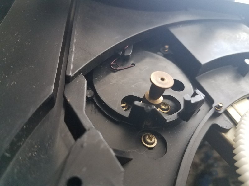

I've recently decided to take the plunge and buy a piece of vintage stereo equipment. I picked up a Fisher MC-723 Audio Component System from my local Goodwill for $7, not in working condition:
Turns out, most of the system works fine. The buttons are a bit loose, the hinges on the tape deck could do with some grease and I should definitely remove the cat hair from around the play heads, but apart from that the only non-functioning part is the turntable.
The belt for the drive mechanism is completely missing. I checked the inside of the system to make sure it hadn't slipped off or broken, but it's just vanished. I'm ordering a replacement later today, but apart from that, I need an outside opinion on one of the other parts:
This part here, which I don't know the official name of, that connects to the lever that switches between 33 and 45 RPM. It looks broken. There are a few edges on it that don't look like they're supposed to be there, and if I run a rubber band between the spindle and the motor bearing, it rubs directly against one of the slanted edges.

I don't think you'll find a replacement part. I'd spend some time looking for pictures or a manual with the parts detailed. I guess it's a "C" shape that moves the belt up and down. You'll need to DIY the part, using epoxy glue, or epoxy putty , or even carving a plastic piece and glue it in place. Perhaps a metal "c" covered with epoxy. ..
That was my first thought as well until I put the rubber band on. There's clearly a wheel or some similar part for the belt to rub against that's also missing. When I stretch a band between the spindle and the bearing, it rubs against that part at an angle that I'd bet would damage the belt over time.

The belt will wrap around the platter, not the spindle. Right? Then it shouldn't rub on anything.
Also, a flat belt will auto-center on that brass pulley- But, as stated, the belt goes to the platter, much wider angle.
To measure the size, I tie a cord around the platter, the belt should be of that size, not much larger, to have the proper tension (in my 1st pict, the belt is a bit large, but it was the closer standard size I've found). Or, if the belt is too small, it will force the motor.
Good god, you're right, I have no idea why I thought belts worked that way. Thanks for the heads up.
Managed to find a replacement belt for this exact machine online, will update this post once it arrives.
Update: Replacement belt arrived, it fits perfectly in the configuration you gave and the part I thought was broken/missing changes the speed just fine. Sound quality is better than I was expecting; overall the turntable is functioning flawlessly. The tape deck is another story.
