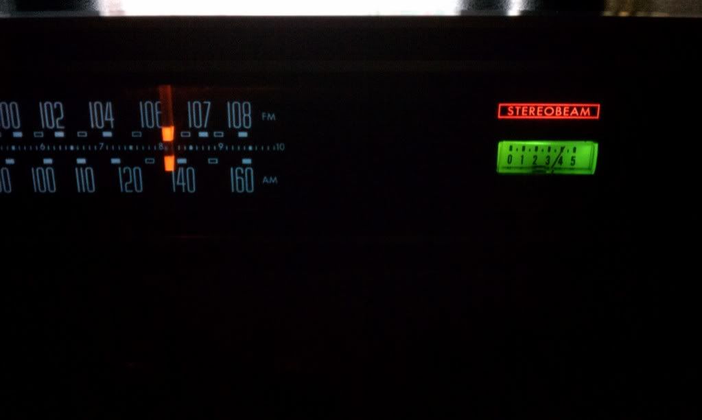

Here's how the receiver currently looks lit up, although the camera I used made the shades of the colors a good bit lighter.
The dial pointer was made orange using a small piece of plastic from a neon indicator light that came from a defunct record player.

I want to say the dial looked like this originally or real close to that. Best I could do with the photo app in Windows 10.

Here's some pictures of the LED mods.
The voltage regulator and the power supply is in the black heat shrink under where the regulator is.
Indicators
Stereo indicator and meter LEDs
Dial pointer
Resistors
Here's some pictures of the receiver lit up
All colors are a little darker shade than what the camera shows.
Interestingly this first picture the blue shows two distinct shades, but isn't really like that.

The stereobeam lamps are two red LEDs from a LED christmas light string and just connect where the original bulbs did no dropping resistors necessary.
The meter lamps I used were green LEDs from the same LED christmas light string only I used three in series to eliminate a dark spot in the middle of the meter.
The dial pointer is a single orange LED from the same LED christmas light string.
