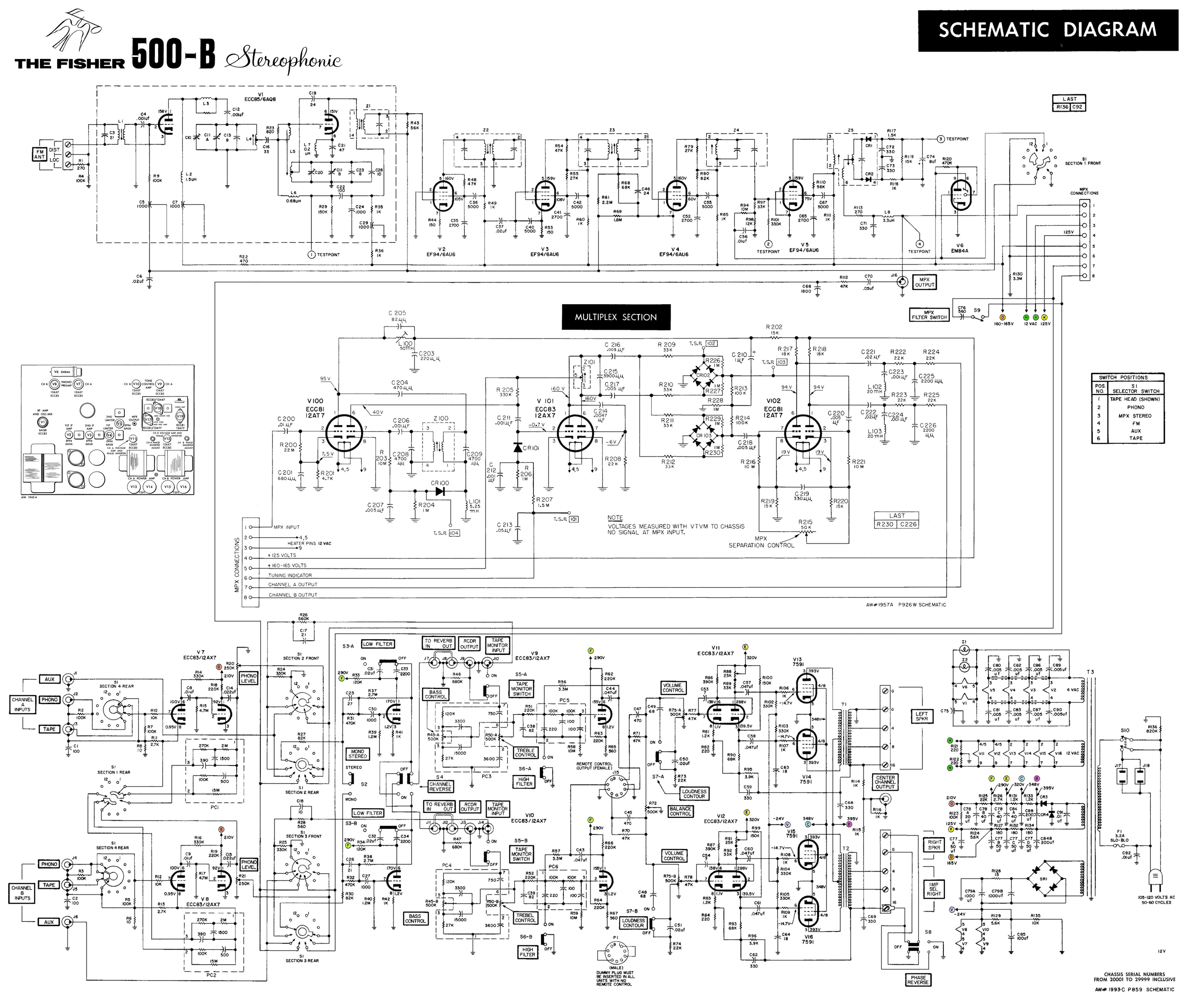

Here's a link to download the schematic. Do this first to get a better feel for what you may be tackling.
Just a little public service announcement. ;)
Thank you for the schematic. Is there any chance you have access to one for the later builds? Mine has a serial number in the 37,000 range. I'm not at all sure I'll end up trying this myself, but pairing the receiver with its schematic might help whomever gets this thing back to making music.
No, that is the best schematic that I could find on the 500B.

I have the service manual for serial numbers 20001 to 39999. I can email it but it is too big to attach here. You can also download it from HiFiEngine but you have to sign up for an account.
This is for a 500-B, serial number 36500+
http://www.wwdsltd.com/files/Fisher 500-B Schematic sn 36501.jpg
The limits of the thumbnail sizes allowed here diminish the resolution to a nearly unusable image. The linked file is clear enough at 13" x 15" @ 300DPI
