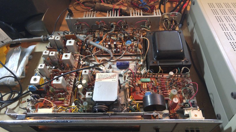

This is the problem Description
The FISHER 505T receiver was thoroughly renovated. The FM tuner and Multiflex tuner were tuned to what looked like proper tuning ...
The diagnosis was that the FM separation between the two channels was very low. Compared to other receivers, it turned out that this was indeed the case. There is no real seperation between L and R (theer is some slight).

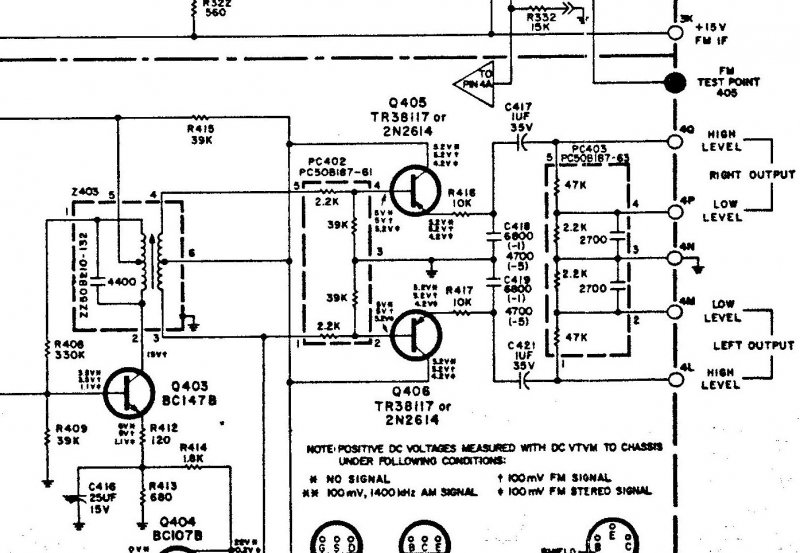

This is circuit of the FM-IF and MPX stages. (where do i see the American vs European FM (de-emphasis) selection ...)
There is a kind of a filter at the MPX output. I guess it is for attenuation as well as frequency compensation.
I have bypassed the filters and conncted directly to the L and R outputs. well ... the seperation is much more obvious. however bypassing the filter casues high frequency and also hi level distortion.
I do not have an MPX FM generator, so the tuning was done via a broadcasting station to the FM-IF level and a scope was used to tune the multiplex decoder frequencies. everything seems to work fine ... there is no malfunction and is this the way it functions ? strange isn't it ...

If you've got a good 38 kHz presence at the collector of Q403, and the balanced detectors Q405 and Q406 are good, then all you're really left which is alignment issues. Have you connected your scope to the 19 kHz and 38 kHz sources within the decoder to confirm what kind of Lissajous pattern you're getting? If you can post those, then it will be easier to see if alignment is really the issue.

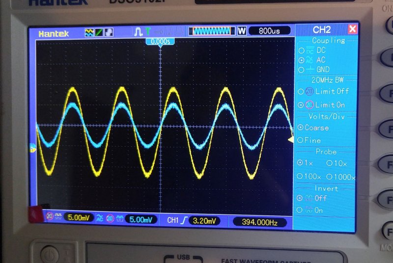

JD -- Not at all true. I just finished up a thread in this forum where by I convert one of Fisher's Crosby based vacuum tube stereo tuner/preamp units (one of their "oops" units) to operate correctly with one of their "WX" MPX sub-chassis decoders installed. This is one of their classic 3 tube GE/Zenith based MPX decoders that Fisher used in all of their "Wide-Band" tuners throughout the 60s. A very similar version of it -- the MPX-65 -- was used in all of their MPX receivers of that day as well. Like the SS circuit you are dealing with, these are a classic time-division designs that were in large part responsible for the enviable position that Fisher achieved and held onto when it came to FM Stereo MPX performance. For the record, the stereo separation performance produced from that project can be seen in this L only scope shot here:
A R only scope shot looks identical to this one. These are the result of over-the-air (broadcast) MPX test signals transmitted to the 202-T's tuner section. The measured separation from both L to R and R to L is 38 db at 1 kHz.
The scope shot you provide shows virtually no separation at all, so something is very wrong. A couple of questions:

3. If your pilot and sub-carrier signals are good, and both of the L-R demodulators are good, then you are invariably coming down to a phase problem -- either the 38 kHz oscillator is not being properly triggered by the pilot signal, or (more likely) the phase of the injected composite signal into the 38 kHz demodulators has been disrupted.
4. Regarding the phase of the composite signal, it is injected into the L-R demodulators (via the Sec CT of the 38 kHz osc transformer) by the composite coupling cap shown at the bottom center of the full schematic. I can't make out what the value of the cap is, but it is invariably an electrolytic cap, and when it develops a problem, separation problems are the inevitable result. You cannot rely on using a simple cap tester to verify the integrity of this cap. If it is the original cap, then I strongly suggest testing it by lifting one lead of the old one and substituting in a known good one to check the performance of the original cap. The vacuum tube decoders use a 1 uF electrolytic cap in a similar position of their design, and it was a known failure point over time in those units. When it goes, the L+R audio would commonly make it through the cap just fine, but the L-R sidebands would not. Because the audio would get through, the cap's failure would not make itself immediately apparent. But of course, the poor coupling of the sideband information produced all manner of separation problems due to the cap's deterioration. Check the integrity of this cap carefully to determine if it is either the problem, or can be eliminated as a potential one. If this cap has failed and you have tried to compensate by aligning the MPX section while it was still in the circuit, then replacing it will likely necessitate your having to realign the section again for it to operate properly.

Do you refer to the coupling capacitor C412 or to C413 ?
Here's a better image link of the tuner schematic.
https://drive.google.com/file/d/0Bz32O2xTTVQtbjMzbmRPcHBVdVk/view?usp=sharing_eil&ts=59846f8c
