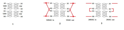

normally with dual voltage primaries you get a pair of 120v windings. They wire in parallel for 120v operation or in series for 240v operation. It will work if only one primary is connected but its good for about 1/2 the current.
This for example, different sort of transformer but the primary side is the same idea
with this one the extra set may be 0, 100, and 120v so it can be used in Japan on 100v mains. 0v on both wire together, 120v on both wire together, and mains is fed between 0 and 100v for that setup.
Hi, yes that standard 2 primary 4-wire multi voltage winding scheme I fully understand and have seen many times. But again in this case given this extra winding is 3 wires and the regular primary has two, still not sure how that would tie together.

maybe @RS Steve knows. I believe he's got a couple of 1800's, which is the multi-volt version of the 800C. I'd take a wild stab and say its going to be similar, even if its not the same transformer exactly.
but I suspect its still going to be like wiring the 120/240v setup just with one extra lead that doesn't get used. That extra lead is probably a tap on a 120v primary so it can be used on 100 volts.
This is the only way I could figure this extra primary to help with compatibility with other primary voltages, but still not sure.
In any event if this would be the case, and since I would use 120V mains seems I would not need to bother with the other primary... or is there anything else involved.
