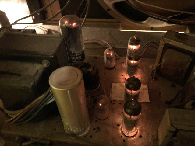

Inside pics?
If you can, take the back off and watch the tubes start to glow. On the main amp, check to see if the big tube (5U4GB or 3DG4) is lighting up. It may not be your problem but this is the first thing I think of when someone says it was working and then faded out to nothing.
Could also be the first filter capacitor is bad. If it is all original, it sure could do with a recap but I think I would find the initial problem first before replacing any capacitors.
Slowly fading out sounds like either the rectifier losing output voltage, or leaky coupling caps swamping the output tubes. Its more than old enough to need some TLC at this point.
Inside pics?
I took the back off to check the tubes while the console was turned on to see which ones got warm.
I decided to lightly touch the 5U4GB to see if it had any heat since it wasn't lit. When I touched it, it lit up and the music came back. @cademan, you're right!
Now it's playing again. So, what can I do to make sure that it's not so sensitive to how the tube is seated? I barely touched it, and it started up again, so any bumps to the cabinet could disconnect it again. With a family in the house, it'll get bumped.
Also the console still has a hum when it's on and there are no inputs.

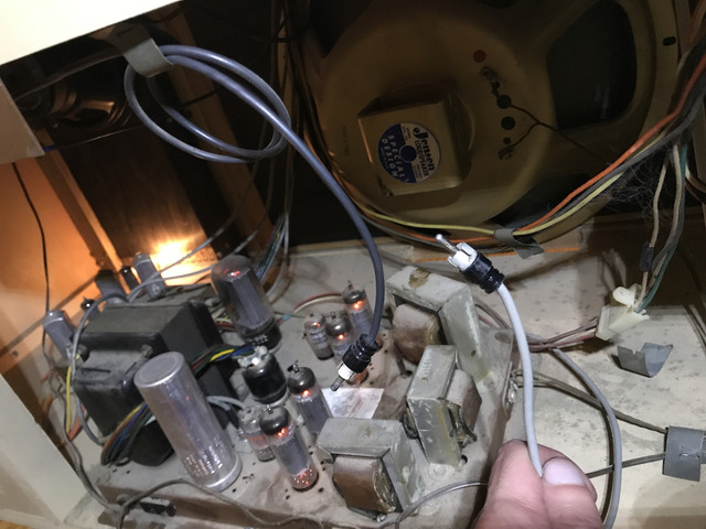

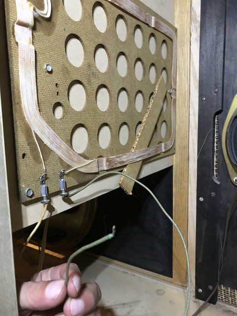

As requested: some other photos of the inside.There are some wires that I haven't figured out where they go exactly. The service manual only has the control panel, speakers and amp section pictures below.
The green wire comes off what looks like a radio antenna. I can't figure out where the green wire is supposed to go. The white wire from the antenna goes to the tuner where there are a lot of what look like repeating cams, but I can't find a corresponding connection for the green wire anywhere near the white one. I'll get more pictures of that soon.
The black RCA goes to the external tape input. The grey starts plugged into the tuner chassis in a port labeled 'FM Input from Tuner,' but it doesn't actually connect to the tuner. I need to sort that out. There are two empty RCA connections at the bottom of the tuner I need to investigate.
My service manual does not have this FM-Stereo unit listed. When I have the console set to 'tuner' the tube lights up. The two top RCA cords go up to the control panel, but are not connected. On the control panel there is a single 'Tuner' RCA port that went to a cord running to an external tuner RCA port on the back of the console. I haven't found the service manual for the tuner yet. When I turn on the tuner it lights up, the little baby oscilloscope is green and changes depending on the station, but it doesn't seem to be connected and I'm struggling with how to connect it.

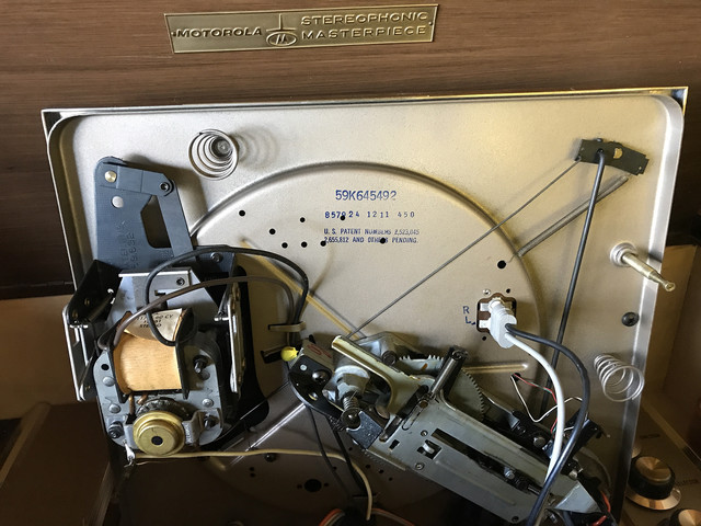

The turntable stopped working, the cycle for autoplaying seems to be broken, starting and stopping itself, never playing for long. A month ago I could turn on the turntable using the REJ/on/off dial on the turntable, and then just manually move the arm onto the record. If I went past 'on' to the REJ, it would start the auto feature, but now it automatically moves the arm no matter what I do. And then, messing with the dials and turning the console off and on again, it's working again without the autoplay. So strange. Whenever I change the Tuner dial from AM/FM/Phone to the Phono setting I get a loud pop through the speakers, which I also get when going to the LP setting on the control panel dial.
FYI the LP in this video is an old junk record to test on, I'm not destroying something vintage and valuable.
My goal is to return this console to full function, so I can use the radio, turntable and tape/RCA inputs. Currently only the tape/RCA input is working when the rectifier is seated properly.
trip linkage is probably gummy. Looks like a Voice of Music changer. There are probably guides on here somewhere about how to overhaul a VM 1200, or thevoiceofmusic.com has info and parts. The mechanisms aren't real complex. Pull the platter off and de-gunk the stuff under there. On the bottom side the whole mechanism is under a plate. That plate comes out and you can get to all the parts and pieces.
Something I've found with VM changers is the motor mounts are usually bad and sagging. The idler wheels are hit and miss, but they cannot be sanded to refresh them. Its a 2 step idler so the diameters are critical to get proper speed.

Turntable: When I've cleaned old car electronics (german 70's cruise control systems) I used small machinist acid brushes and spray electronics cleaner to get out the old grease before re-lubing with some dielectric grease. Would this process be safe and effective on the turntable? I can inspect the motor mounts and see about replacing them or fabricating a replacement.
yep thats fine. Mineral spirits works well to remove petrified lube. In extreme cases I've even used acetone or Brakleen, but do not get that on anything painted or plastic. These things are probably a fair bit less fragile than anything that came out of Germany. The platter and the motor want some sort of light oil in the bearing. I like hydraulic oil or sewing machine oil, but any similar light oil is fine. Don't get any oil on the inside of the platter, the idler wheel, or the motor spindle. An alcohol wipe on all of those surfaces before re-assembly would be a good idea. I use SylGlide from Napa for grease, but its basically just dielectric grease. White lithium is also fine. It uses very little lube overall, just a small amount in a few spots.
thevoiceofmusic.com has the motor mounts for a couple bucks a set if you do need them.
@gadget73 Perfect, thank you. I have some machinists oil I can use. I watched a video on youtube about dismantling and cleaning the turntable, and it looks fairly straightforward as long as I don't lose that little ball bearing...

If you have not already obtained the schematics, you can get them here. Use the drop down then scroll down to the SK30B selection and get the whole package. Would you post a pic of the inside and your tuner? For the best performace and longevity You REALLY REALLY REALLY need to recap the amp including that can filter cap.
I think this is the MPX unit, mine goes to a separate MPX amp but it looks like yours may be build into your main amp. the later pic where you are holding a cord for FM tuner may plug into this
