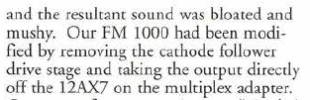

I was close but not quite! In Issue 5, page 11 in the tuner shootout, the modification skipping the output stage was on the FM-1000, not the FM-200B. Thanks!
looks like this is what they removed
If the output level was too much I may have considered making the EF86 run in triode mode, or perhaps bypassing just that stage but leaving the cathode follower. I like the low output impedance you get from a follower stage.
