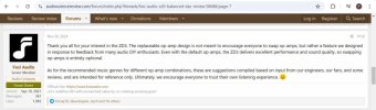

You can roll the op-amps. There are three in total. For me, it sounds great out of the box so I don't plan to change them.
The Fosi ZD3 is a very good affordable DAC. The user interface is also well thought out, and the included remote nice. I think that it gives it a mark above it's competitors (there sure are many DACs out there..).
And as already stated; Yes, you can roll op-amps!
I'm not decided on the topic, think that Fosi did a good job with the standard op-amp chips in the ZD3.
I'm inclined to look at the op-amps that top scoring DACs use, your rolling experience is welcome. :)
P.s. Also good to know is that the DAC chip (that you cannot replace without serious surgery to the DAC of course..) is the ESS 'Sabre' ES9039Q2M.
ESS posted their chip specs here: https://www.esstech.com/products-overview/digital-to-analog-converters/sabre-audiophile-dacs/
P.p.s; Edit: Fosi's own take on the subject:
