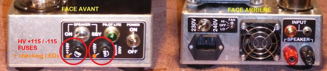

Now looking to the first schematic (upper), you understand why this floating DC power supply can't kill the speaker if a tube goes bad. That's what I use in my U-OTL. I have made the security tests : removal of a tube, shorting of a tube (the + and the - going directly to the 6080 are each protected by a fuse, just in case).
The 6080 protection fuse located on the front face, each with a failure red Led indicator :
That said, my 10WRMS U-OTL have nothing to do with those Big OTL Amps, like the 200WRMS upgraded Futterman OTL-3 owned by @Jfaustus : not the same power involved, not the same complexity of the circuits, hence a reduced risks of failure.
