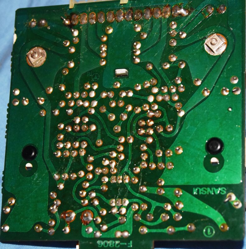

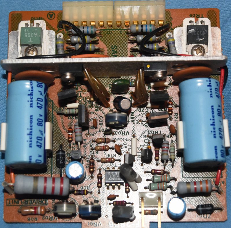

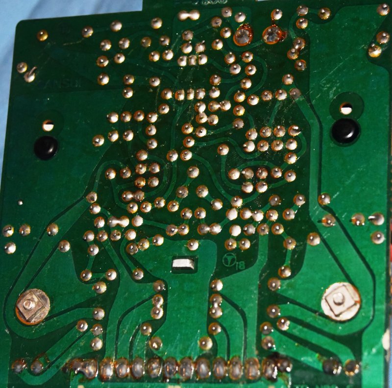

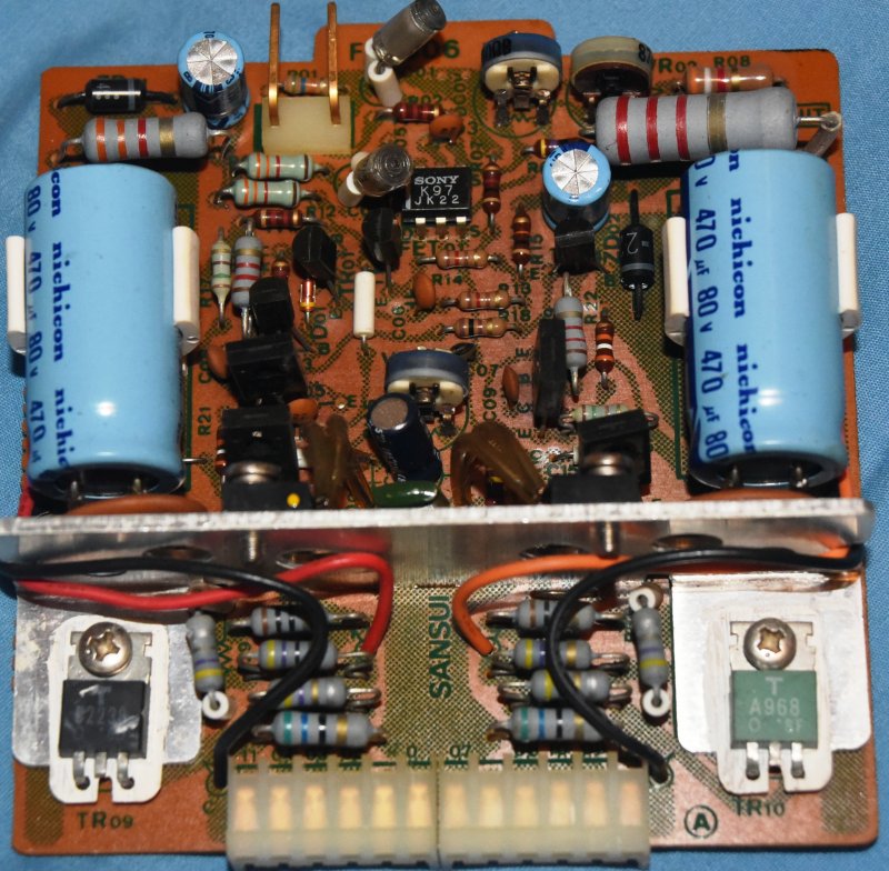

Well I can't seem to add photos. I created an album and added the pictures to it but then it said I didn't have any in there. Maybe I have to wait awhile? I was a bit disappointed to see that the sight is downsizing my hi-res pictures even though I got them under 10 meg. I'm not sure if anyone will be able to spot anything I'm not seeing but I'd at least like to see if someone can. I'm not at all comfortable with rewetting all of the solder connections. It would be great practice for me and I even have a new tip for my Weller butane but this is not a board I really want to practice on! Can anyone tell me what might be wrong with my photo posting?
Seems to me that some transistors were replaced, can you read the transistors labels?
Check the solder for hairline fractures and I can't see very well but check the this points.
Hipocrates, that spot at the bottom left was some of that yellow goo that I flaked right off. I see nothing on the top spot. Generally speaking, all of the solder joints look pretty darn good to me. Where would I read any transistor labels? The transistors are the little things with colored rings right? I don't see any writing on them. And what would FR (R17, 20) be? I assume it's some component on the board. That's right folks, I pretty much know nothing at this level.
Umm - unless I am mistaken - looking at your pic #4291 - it looks like there are some Hitach 2SC 458's in that board - could this be correct? Could thse be subs someone later dropped in? If this is correct then these are most likely to be your culprit. They are the "boxey, slopey" looking square transistors - very distinctive-looking. can you check their numbers?
Those are fusible resistors usually fails... so you have to replace it for metal film, R15, R20(location) the value is 150Ω 1W (i think)... those can cause some problems.
the transistors are the little back boxes with three legs
red circle--> transistors
yellow circle---> "fusistors" (pet name for fusible resistors)
