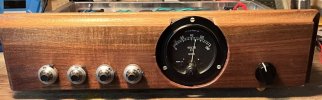

Will also add a couple of photos of fine speed control devices I’ve built or used, these are just for fine speed control….this device controls both Hz and voltage so it controls all speed, 33, 45 78 without changing the table’s speed lever—note the voltage reading on the power supply meter ;)
The last one is an old voltage control/selection device the voltage output will be slightly higher than what listed on the device because of the higher supplied voltage at the outlet these days compared to when it was made
The in series light bulb will also suffice, but again its more of a bias speed control
