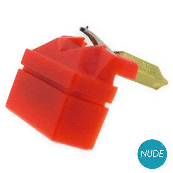

My M104E stylus recently got damaged in a move (the arm became dislodged and swung around) and I've been looking for a replacement. It seems I cannot find a genuine replacement anywhere and anything online looks too cheap to be a decent-quality, diamond-tip stylus.
https://www.dacapoaudio.com/1866-Shure-N-104-E-styli.html
The JICO isn't a possibility for me as I live in the US and the others were wrong or seemed too cheap
This one seemed decent but I'm still weary of the quality of the stylus
I'm unfamiliar with vintage turntable knowledge and price ranges, more the audio engineering side, and not stylus build quality.
Any advice or recommendations? Thanks!

You can still find originals at the main auction site, but as part of a NOS cartridge deals. Radio Shack RXT-5, 6, etc.. Many of these styli will fit. If you are particular about that Shure sound (finesse and balance in midrange), no aftermarkets will replace it, especially inexpensive ones. I tried (even JICO's) and gave up, only NOS remain as option for me.

The RXT5 is a p-mount version of the M97 Era IV. The RXT6 is NOT an M111HE; the M110 and M111 are also M97 Era IV generators. The RXT6 is the same as the RXP3 and M104. The RXT6 is the same generator as the later M97xE (which is why the M97xE was SO cheap originally at $70. Many later Shures used the rolled-off treble generator that was basically “surplused” into the 1997 M97xE.)
A superb stylus for all of these (M104, RXT6, RXP3) is the Jico-made N97LT stylus. $30 shipped. Tracks perfectly at 1.25 grams.

Yes. An original 104E stylus is not exactly a great stylus to begin with. It’s the same stylus as used on the RXP3, of which I have 2, 1 NOS and one lightly used. Nothing to write home about. The N97LT is a better sounding stylus, made for a better sounding cartridge. The N97LT stylus is an upgrade.

The EVG Japan stylus is made by Jico, to the same standards as a Jico from Japan, because a Jico stylus is made by Jico. Back about 7 years ago, EVG had a contract with Jico to supply its styli. Only a few are still in stock by VOM; I cleaned up back then and bought Jico styli for my Shures (M97HE, V15-IV, and p-mounts, ADC XLM, 220XE, 10E MKIV, Pickering/Stanton XV15 and 681EEE, and others). Since then, around 2018, Jico terminated its contract with EVG. VOM is one of very few suppliers that still has stock of the Jico N97LT (N97DLT) styli. If memory serves, the M104E/RXP3 is a bonded 2x7 elliptical. The N97LT is a bonded 3x7 elliptical.
I can say this: The Jico N97LT is a superior stylus to the original Shure N104E/RXP3/RXT6 stylus. That’s because Jico made it the Shure standards of the N97LT stylus, a better stylus for a superior cartridge to the M104E. The M97LT cartridge was a very good cartridge, with the M111HE and M110HE.

The N97LT has a low profile grip, and so fits most all Shure p-mounts:
