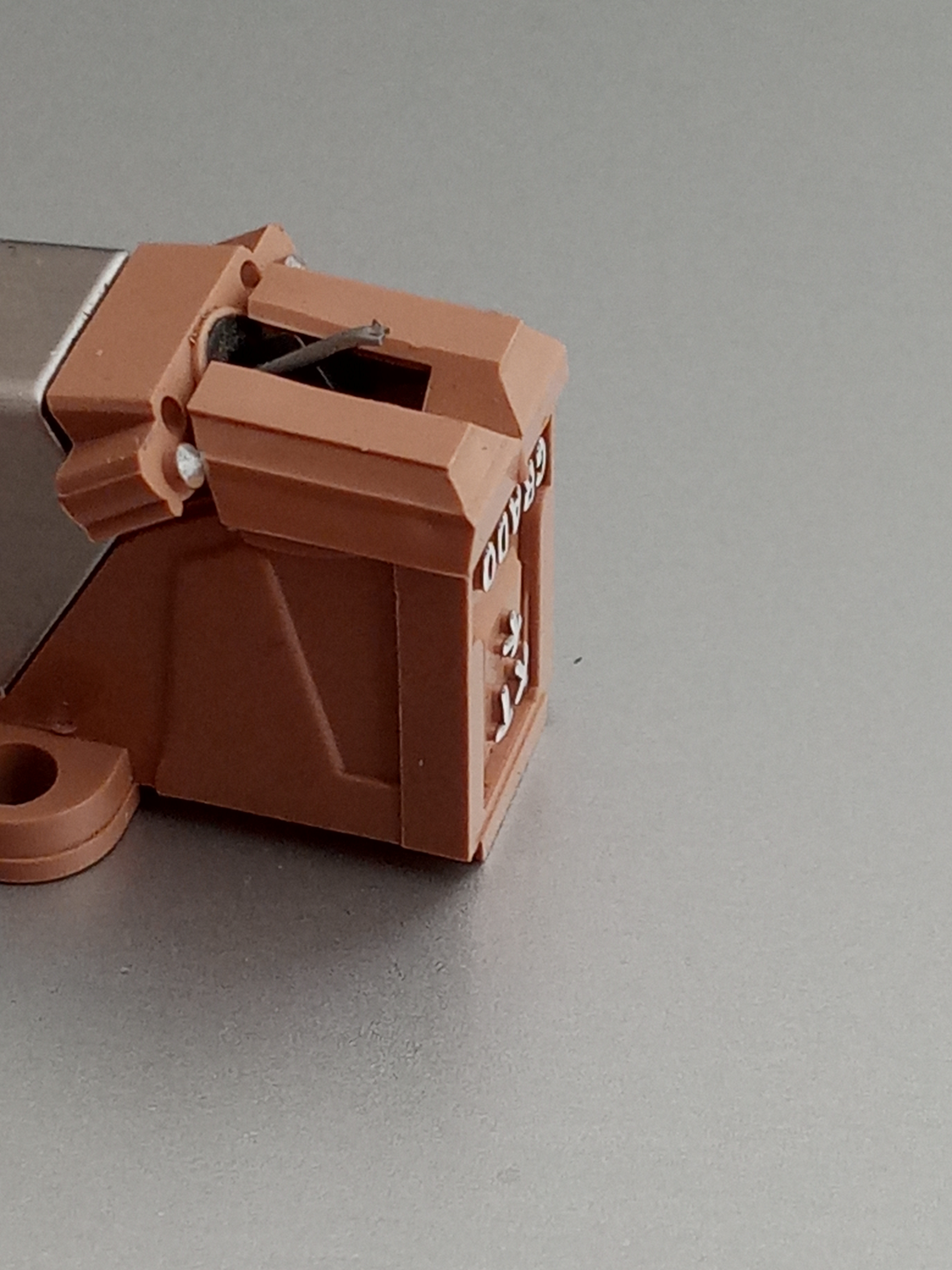

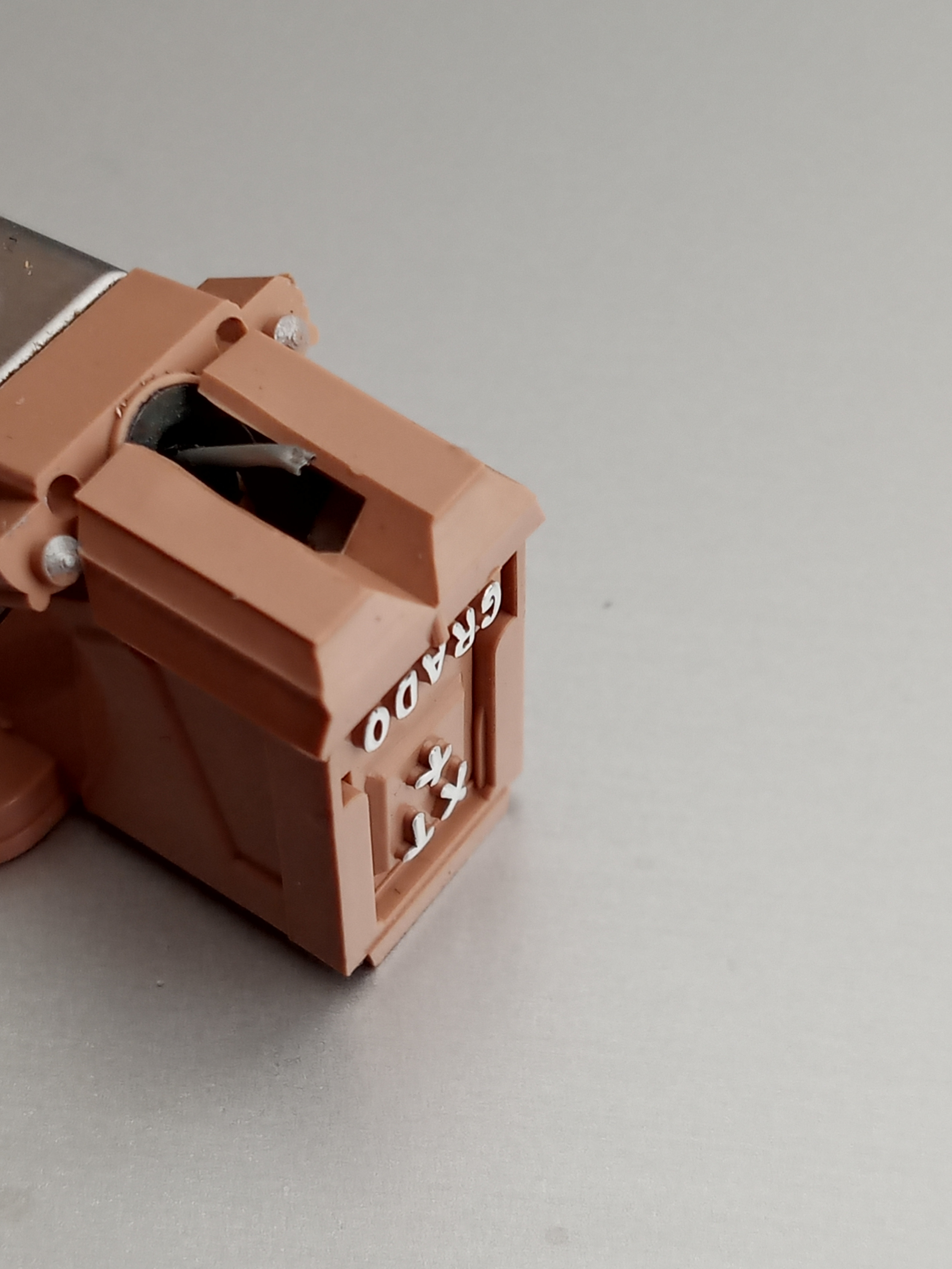

There is no metal plate in the front of a Grado behind plastic. Here's some photos of an XT+ (E87) for reference. Someone glued that green plate on. Probably painted it green themselves. That's my best guess anyway.
Best picture definition I can do.
