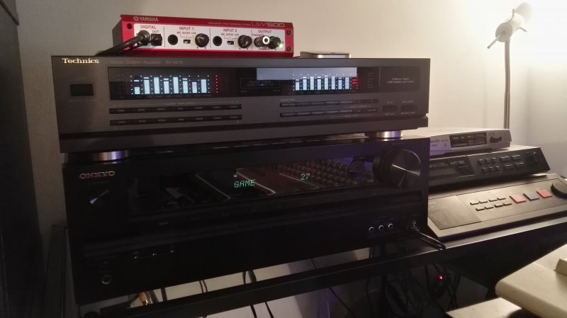

Hi all, after some advice please..
I've been doing some research but can't find a definitive answer as to whether it is possible to hook up my Technics SH-GE70 graphic equalizer to my Onkyo HT-R548 home cinema amp.
The Onkyo amp doesn't have a tape monitor or pre-amp in and outs (only a preout for subwoofer) but it does have VCR/DVD in and out. I also have a separate source selector box that I can add into the mix if needs be.
Pic of Onkyo connections: http://www.intl.onkyo.com/products/av_components/av_receivers/ht-r548/im_rear.jpg
Pic of SH-GE70 connections: http://hifiaudiophilevintage.qis.ro...tz-sansui-pioneer_MPE-F-4314529390_052013.jpg
Input selector box: https://goo.gl/pvEcLD
I am wondering whether the simplest option would be to connect the source selector box output to the line in on the GE and then line out from GE to a source (eg AUX) in on the amp. My turntable has a inbuilt phono stage so I can also plug that into the input selector box.
Any advice will be gratefully received.
If you want the option of multiple inputs, that's the simplest solution.
Yeah, the source selector -> EQ -> receiver option is the best option. In fact, it's the only option.

It was actually the speaker (Wharfedale Diamond 9.0) grilles - I refitted them while swapping amps in case I damaged one as I'm working in a confined space. Took them off and the sound went from muddy and very flat to full, crisp and detailed - basically very similar to what it was through the Technics amp, albeit I had to up the bass a little via the GE. Alan Parsons Project sounding as they should again.. Thanks for everybody's input.
