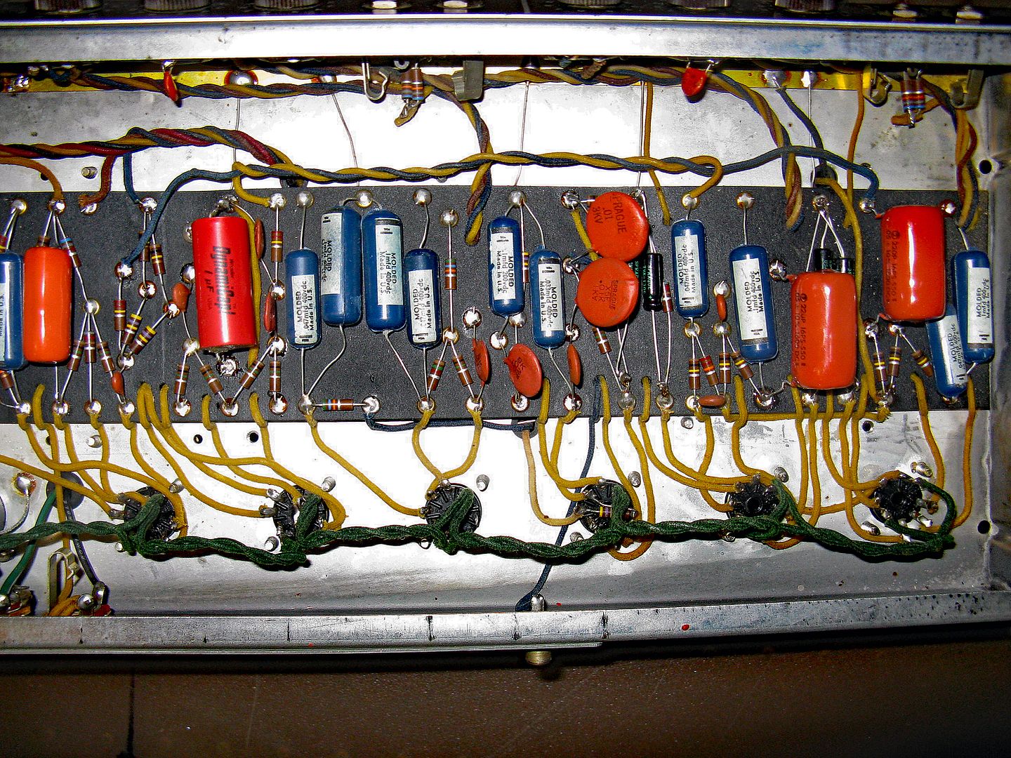

I've had my 808 for over 20 years. Keep the tip and all else clean. Tinned the tip and it's good to go.
The only way to do a clean resolder job. :thumbsup:
