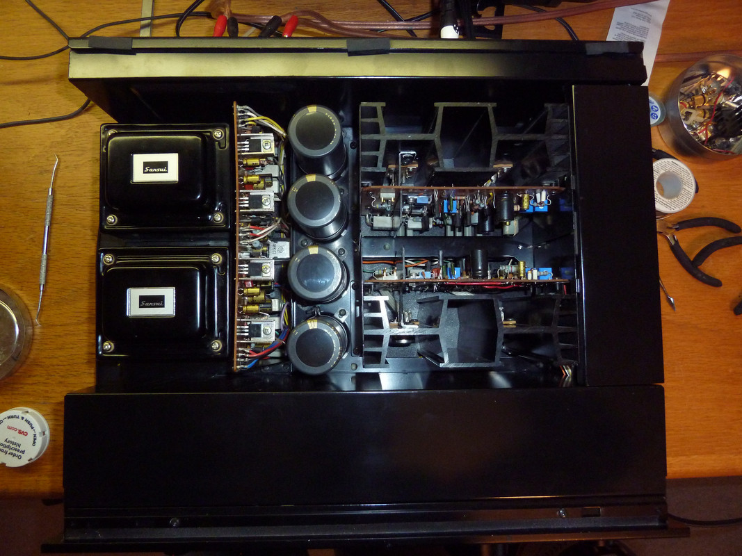

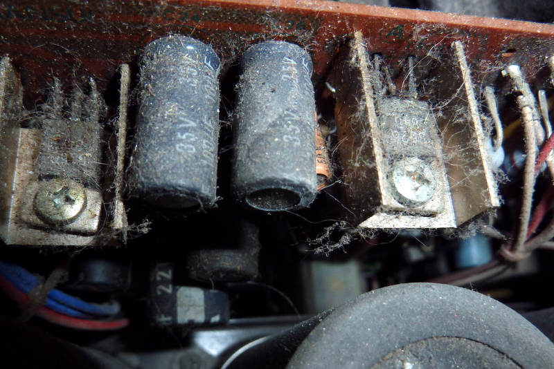

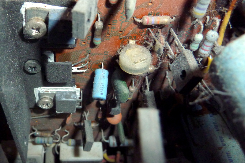

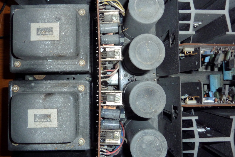

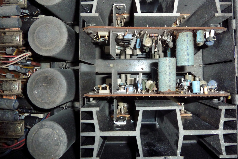

So I'm still waiting on a couple of pieces to arrive, in the meantime I've decided to crack open the case and take a look inside.
Woof, I know it hasn't been submerged but wow look at that grime!
Similar to the one I did a few years ago. It looked like it came from the wreck of the Titanic. Cleaned up pretty well, though:
