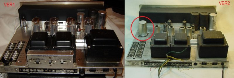

The HK250, A250 and A260 (ver1) ALL use the exact same "FT2382666B" output transformers (7000 ohm Pri-Z). But when researching these amps I learned there are actually 2 different versions of the A260 with a different output and power transformer and filter cap arrangement. Both versions have a 150VAC winding and a doubler with solid-state rectification to provide ~400VDC to the OPTs and roughly 390-395 VDC to the plates. But the earlier version (I will call ver1) can easily be identified by only 3 top side electrolytic caps while ver2 has 4 (2 paper 2 metal). The addition being a metal can added in a position on the right hand side just forward of the RCA input panel (as shown in the A260 SAMs I have which only supports ver2)
Version 1 A260 uses the exact same "FT2382665E" power transformer as used the A250 and HK250. That PTX has a 17VAC winding that on the A250 is used for the DC heating of V1 V2 V3 via a full wave diode rectifier. (those leads are blunt cut on the he HK250 as it is a power amp so it doesn't require DC heating for preamp tubes) But on the ver1 A260 in order for the 17VAC to be able to provide DC heating AND create the -30VDC bias voltage it adds a twin capacitor doubler combined with single diode rectification.
But the improved ver2 power transformer (labelled FT2963803) is equipped with a convenient 36VAC winding, eliminating the need for the doubler and also uses single diode to provide DC for heating for the preamp tubes and leaving around -30VDC for the negative bias. The OPTs on the ver2 are labelled FT2963804A and have more ideal loading at 4400 ohm Pri-Z necessary to push 30+ watts of output power in push-pull.

I will find a couple photos tomorrow
