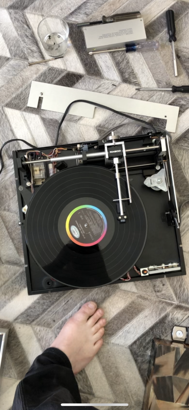

A few years ago I got bitten by the linear tracking turntable bug. There's something exciting to me about seeing all the different ways that various companies solved the problem of tonearm movement. The HK/Rabco design is one of the most interesting to me, in all of its low-tech glory. I have repaired a few of these over the years but recently ran into something interesting.
My first run-in with the ST range was the ST-7 which used the first iteration of the design: a static, non-rotating upper bar. I acquired an ST-5 later on and noted the published improvements, namely a new grooved wheel at the far right side of the upper bar rotated via a belt attached to the lower rotating barrel. Everything I had read indicated that this was the mechanism that also powered the ST-8 and any factory retrofit ST-7s.
Imagine my surprise when recently repairing an ST-8 upon finding a very different mechanism than I had previously seen. In this model the upper bar is half length (not continuing under the shroud on the left) and the rotation is derived from a wheel on the *left* side attached to a grooved pulley on the rotating barrel that doesn't exist on any other model I've disassembled. I haven't been able to find any information at all about ST-8 revisions, but I'd assume this is a later model. There are also differences in the tonearm from the ones I have seen before, with a ribbed cartridge hood that extends further than the flat sheeting metal of teh previous version.
Has anyone else noted these differences?

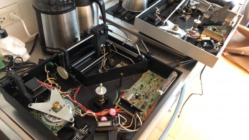

I too was surprised to see this change, from the ST-7 to the ST-8, and then to the ST-5. The ST-5 configuration requires a substantial dis-assembly to replace the upper belt, whereas the ST-8 belt replacement can be made quite easily.
The other interesting ST-8 change I've found is in the height of the chassis (the black aluminum vertical housing / outer shell). I have two ST-8s, one where the black shell is 2-5/8" high, and one where it is 2-1/4" high - which is the same as that on the ST-7s and ST-5s.
The Harman Kardon name is printed on the left side of the front face in the shorted version and on the right on the taller.
Upon further study, the actual chassis, with all components, are exactly the same. The difference is that the taller housing is mounted to the bottom chassis plate about 3/8" lower, so on the taller version the bottom of the housing is flush with the bottom of the chassis plate, whereas on the shorter housing is mounted flush with the lip of the chassis plate, which, due to the bowl-like character of the bottom plate is about 3/8" higher than the middle of the plate. So the tops of the two turntables, with the feet on, are at the same height. as are all components, etc.IMG_3539.jpg
