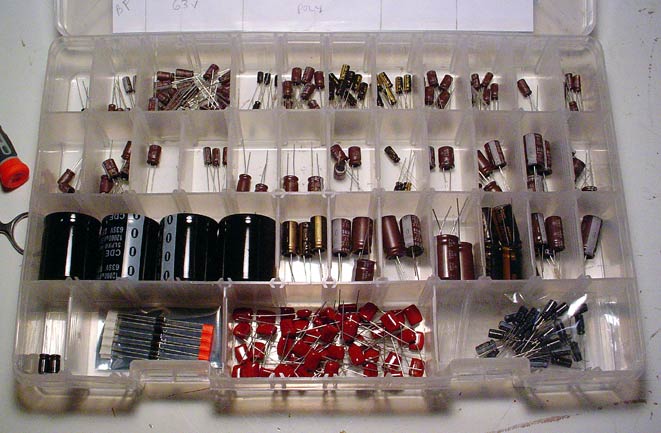

Here's what old sui caps look like if that helps ... <G>

Pretty much anything in the signal path benefits from being "audio grade" ...
One thing about the Elna Silmic II's to remember ... they DO need to clock some hours to break in properly. You'll usually hear a noticeable improvement after around 50 hours of play time.
Love them Silmic's !
Cerafine's another good option if the values you need aren't available.
PS ... Those were all for the QRX 9001. I did find a set of Elna "audio grade" power caps after that pic was taken. :banana:
