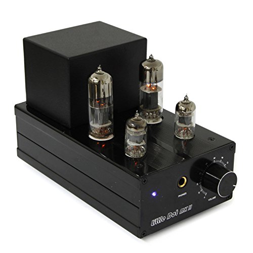

I use a Little Dot MKII. It's an OTL design with multiple gain settings and easy tube rolling. I feed it directly from a Topping D-10 DAC.
