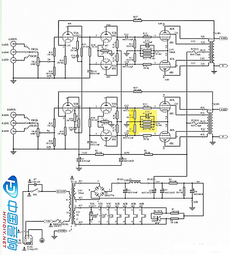

Looks like a classic cathode bias amp. Nothing to adjust here.

two areas you may want to check.
1. A leaking coupling cap going to the suspect tube or tubes (look for DC on the outboard side of the cap).
2. check for lose pins on the tube socket. Some Chinese sockets do not hold their tension well and will relax their grip on the pin over time. Could also cause your redplating issue.,
^^ besides this, if the grid to ground resistor is a stupid value or making bad connection it will do the same thing. If the socket is not making contact its the same as not having a grid to ground resistor so far as the tube is concerned. In cathode bias mode it allows up to 1 megohm, so it would really have to be a stupid value to cause problems.
Schematics online are poor for this unit. I noticed that the amp has multiple parallel cathode-to-ground resistors. One or two maybe defective or the wrong value.
I also highlighted the grid-to-ground resistors. It's impossible to make out the values of each component. Sorry. :(
There is also a possibility you have two defective output tubes. It's happened before.
