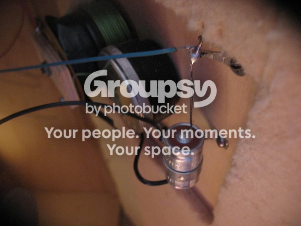

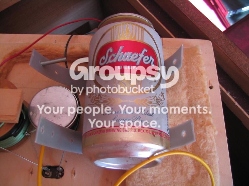

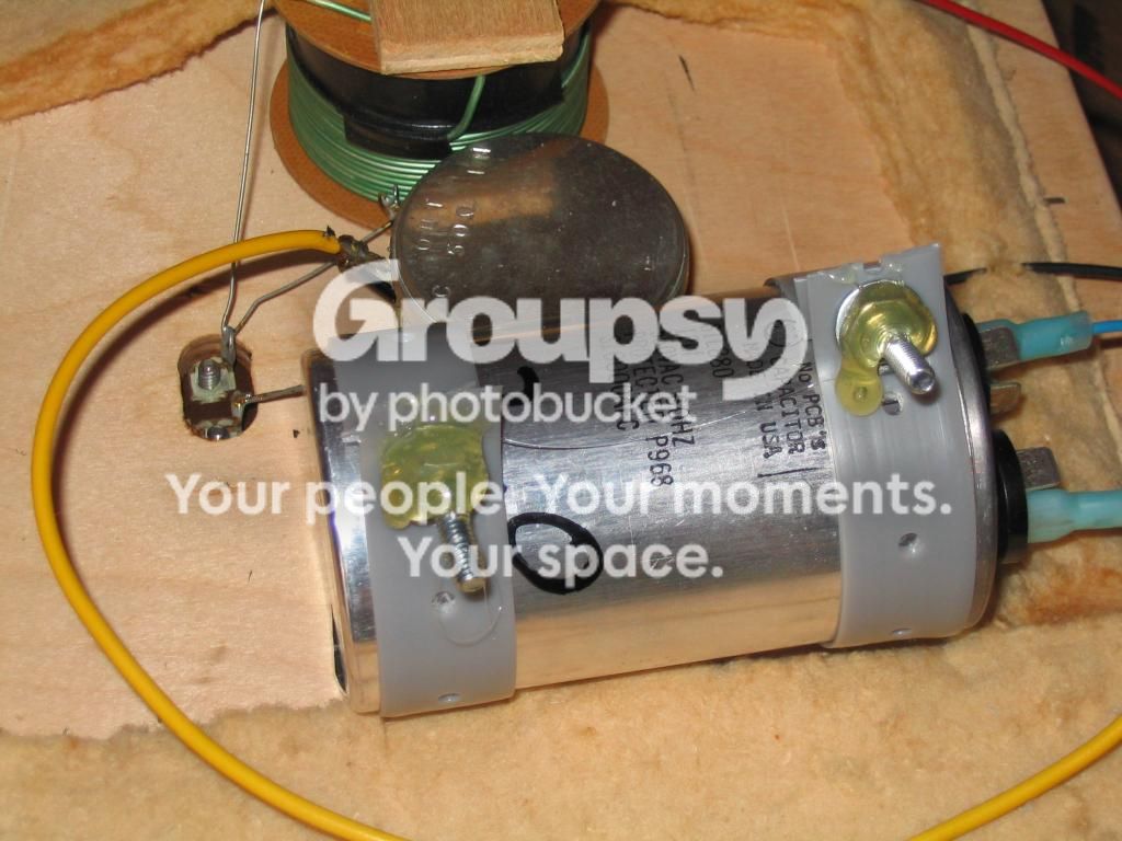

Here are a few pics. We didn't take pictures in the manner of a tutorial or a "how to". I just want to show the cap that was in all three of the W60s and which one replaced it.
Here's the original cap:
Here's the new, much bigger oil cap (no PCBs!)...
Oops...wrong can!
All strapped in, glued, and connected...

Yeah, all my thanks to Sony6060 and Cablephil212. These were NOS GE Dielektrol caps rated at 12 uF, 550 volts AC, 60 Hz purchased off ebay.
