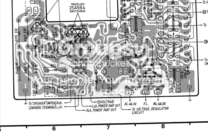

Here is an excerpt from the HFE SU-8080 service manual showing a protection relay HC2A-P-DC24V (bottom left)

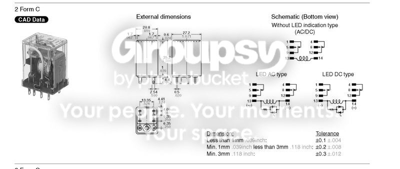

I mis-identified this as DPDT (2 Form C) instead of DPST-NO (2 Form A normally open) - the 8 pins in total threw me. I couldn't find any data on the original relay, which would have helped a lot. The only thing I found was an informative post on another forum which mentioned the original was DPST-NO.
Big question is will my replacement relay HC2E-HP-DC24V-F work? Does it require the two pins 1 and 4 to be energised, or would it basically function once but not reset afterwards?
Any guidance would be much appreciated
It appears from the trace on the service manual that normally closed pins 1&4 are not functional. So pins 5&8 will engage your speakers when the relay is energized. Looks good to me.
P.S. I’d clip pins 1&4 just to make sure they don’t touch any trace when poking thru the board.
Thanks DrumminDaddy, I think I may have actually identified the relay type correctly, and the forum I read DPST-NO from has either mis-identified or worded their reply confusingly! I'm sure a DPST relay would only have 6 pins, not 8?
Looking purely at the trace and the schematic for the replacement relay, as you say it will perform the function correctly regardless of what pins 1&4 are connected to (nothing in this case).
Thanks again
DJS
