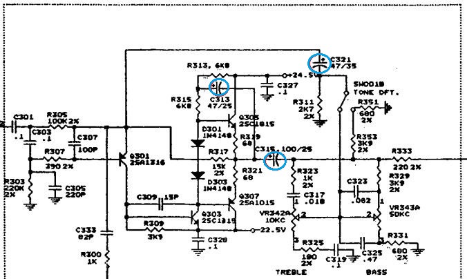

I'm preparing to recap my NAD 1000 and am putting together a spreadsheet of parts to order. I'm trying to stick to Nichicon PW for PSU and power filtering caps. For signal I'm going with Nichicon ES/KZ (WIMA films for really small values).

The preamp section only has three electrolytics per side (circled in red), and seem to me like they're all part of the signal path:
Does that seem correct?

@crv00: I think that your analysis is correct; some additional information follows. Generally, the DC filtering capacitors can be increased in size. In the headphone amp, the 100uF output capacitors can be upgraded to bi-polar types, e.g., Nichicon ES. In the line stage, the 47uF and 100uF capacitors can be replaced with bi-polar types; the 0.1uF capacitors at C301 and C303 can be upgraded to MKP film types. In the phono stage signal path, C201 can be upgraded to a 1uF or 2.2uF stacked film type. The C215 capacitor is part of the high-pass filter for the RIAA equalization and can be upgraded to a bi-polar type, same for C223. The capacitors C205, C219 and C221 are decoupling or noise filters and can be replaced with low ESR types. NAD may have installed polystyrene film types for the pF capacitors in the signal path at C203, C217, C227, C305, C307, C333 and C411, if not, they can be upgraded to MKP film or C0G types.

To respect your color code, the capacitors in the (tone) preamp section should be circled in blue. They must be polarized, as shown in the schematic.

If you measure the ESR of a bipolar electrolytic capacitor, like a Nichicon Muse, you will find it is much higher than a polar capacitor of the same value. For me, a bipolar electrolytic capacitor is not an upgrade to a polar capacitor and should be used with reserve. When there is a DC voltage on a capacitor, it is preferable to use a polar capacitor, unless this is a low capacitance that can be replaced by a film cap. On the tone preamp board for instance, there is a positive voltage (of the order of +0.7V) at the emitter of Q301. The voltage at the junction of R319 and R321 is positive, this is the voltage that provides the bias current to Q301. This is why C315 and C321 have their positive side toward Q301. There is approximately +13V at the junction of R313 and R315, that is why the positive side of C313 is connected at this point.

In the signal path, my preference is to use film capacitors (which are inherently non-polar/bi-polar) whenever possible, i.e., for capacitors that are ≤4.7µF. For larger values I will typically install Nichicon ES bi-polar types. This approach is largely derived from the work of Cyril Bateman who examined the impact of capacitors on sound quality: https://linearaudio.nl/cyril-batemans-capacitor-sound-articles. He tested electrolytic capacitors extensively and demonstrated that in AC coupling, bipolar electrolytic capacitors have the lowest distortion/noise of all the electrolytic types (even the presence of a polarizing voltage) and that film capacitors are generally lower distortion/noise than electrolytic capacitors of any type.
