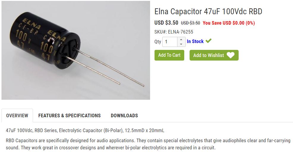

Does anyone have a preferred 47uF NPE for the woofer shunt cap? Does it really matter?

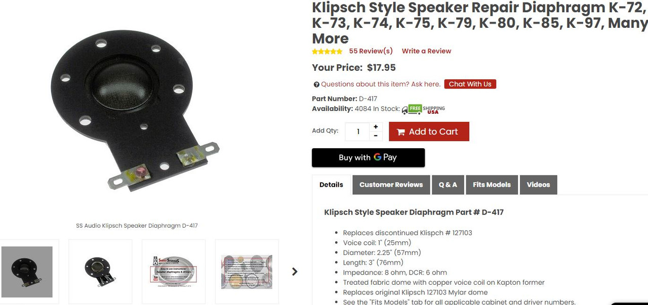

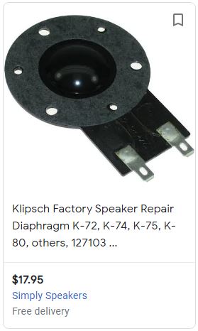

When I do a google search for Klipsch K-75 replacement diaphragms, this is the first item that pops up:
Such a deal, genuine Klipsch factory replacements for $17.95 each deliver to my door! But wait... When I click on the link, here's where it takes me:
Same price, but notice they are no longer Klipsch Factory Repair Diaphragms, they are now Klipsch Style Speaker Diaphragms. Wow, that's a pretty blatant bait and switch - advertise the real deal, but then link to some generic, no name replacements for the same price.
So, if @lico no longer has his original Klipsch diaphragms, does anyone know of a source for the real deal genuine Klipsch Factory Replacement Diaphragms?
Since those diaphragms fit so many other speakers, I doubt Klipsch actually manufactured them.

In the past, I've used Mundorf E-Cap AC NPEs as woofer shunt caps and have been happy with the results. So, that's an option here, but like most NPEs the Mundorff ECAPs have axial leads. They are also pretty large for electrolytics. I can make that work, but it would be easier to use a radial lead NPE, similar to the original. I found the ELNA RBD series of radial NPE caps while poking around the Parts Connexion site:
They specific mention using them in crossovers and it seems like an easy drop in replacement for the originals. Does anyone have experience with these? I think I'm going to go for it. In addition to having radial leads, they are much less expensive and much smaller than the comparable 47uF Mundorf E-Cap

Yes, what Simply Speakers are selling are definitely NOT genuine Klipsch replacements. That's clear just by looking at the photo. I find it very deceptive for them to advertise factory replacement parts, but when you click on the link, it takes you to generic replacements for the exact same price. It seems like they hope most people won't notice the bait and switch tactic.
Not sure why you presume it deceptive. They clearly state that the original part is discontinued. You should call Klipsch and ask about "genuine" parts. I suspect that aftermarket is the only way to go after all these years.
This is why I consider it deceptive. This is what they advertise:
They describe it as a factory replacement, but that's not what they are selling and not the part you get when you click on the link. Maybe at one time, that's what they were selling, but it's not anymore and to continue to advertise it as a factory replacement is deceptive.
