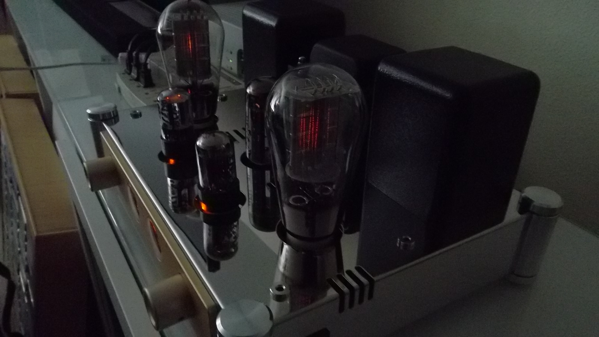

Acme is the old light bulb non-st bottle. I'm not sure how the original western electric sounds like but this is the copy of it and I really like the sound of this tube. Its perfect if you have like a typical 6sn7 black plate Sylvania preamp tube which sound bright then with this output tube has more 3d sound, warm and a lot of bass. I cant ask for anything more.

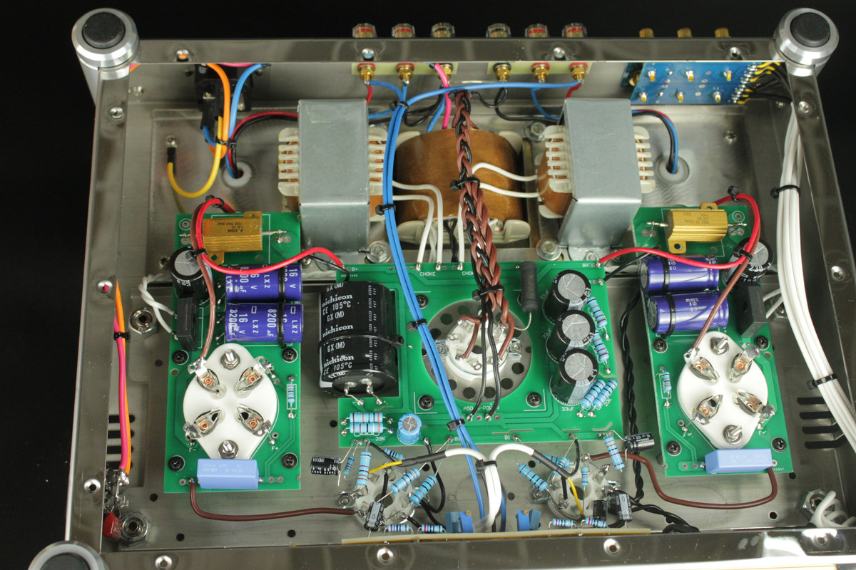

In regards to the schematic which I don't have right now, I been trying to get it since February but I still don't have it yet. Thanks for that link and its really informative.

I assumed that it was a mesh plate tube but I'd never heard of Acme - except in the old Road Runner cartoons. :biggrin: Is that the brand?
The difficulty in finding accurate, or often even inaccurate, schematics for Chinese amps is a common problem. What's the brand and model # of the amp?
I'm not a fan of circuit board construction and it's hard to see exactly how it's wired. But they have a resistor coming off the rectifier which should allow for the use of a somewhat larger first cap. Hopefully the first cap is one of the 33uf ones on the right and not that huge cap on the left.
If you want to try the 5AR4 it would be best to measure the voltages first, then with the 5AR4 installed, bring the amp up slowly with a variac and see how much higher they go. Then do the math to determine that the higher voltages aren't running the tubes, caps, etc too hard.
If you don't have capability to do that, I would stick with either the stock rectifier types (any of the Chinese 5Z3 versions) or a 5U4GB.
