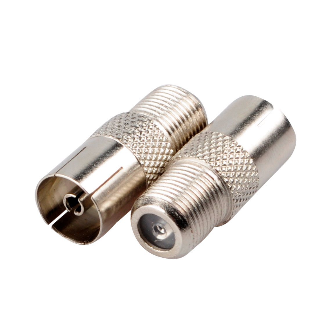

Can't figure out exactly what adaptor I need
to connect F-connector antenna cable to the input.
Can you link me the right one?
Preferably Amazon.
This little tuner, with a short straight wire that came-with seems to hear stations some of my other tuners couldn't in that location. Sounds good, too. Nice for a 4"x4.5"x1.4" box.​
We have discussed this in other forums. i tried to get one from ebay as well, they say it is for DIN style connectors but it dos not fit. It was a RCA to F. Someone said Radio Shack sold one or had made one, I'd have to look to figure out what the part number was. In my case I replaced the DIN with a proper "F" connector as the adapter is a cheap fix if you can find one.
Below is the correct adapter.
This type of connector is commonly called a PAL type connector or a Belling-Lee connector.
As previously mentioned, it is possible to get an incorrect adapter, but if the dealer ships what they claim, you should be good to go.
Although I have no affiliation, I would tend to believe that the major parts suppliers would supply the correct adapter.
BTW, this type of connector dates back to around 1922.
I saw a PAL on Amazon and thought it might work, but Pro-Ject threw me off by calling it a DIN. Thank you, sir. I shall order forthwith. :thumbsup::thumbsup::thumbsup:
Confusing things somewhat, the male PAL and female PAL both look more male than female. On Amazon there are more of the male PAL to female F-connector, than there are female PAL to female F, and the latter is the one I need. I ordered this:

Thank you. :thumbsup: I ordered and received a five-pack:
https://www.amazon.com/gp/product/B01G6EC3OO/ref=oh_aui_detailpage_o01_s00?ie=UTF8&psc=1
Fits perfectly. Once you guys assured me it was a PAL, then I found close-ups of the back of the tuner to determine that I needed a female/female, girl-on-girl type of adaptor. This one works perfectly.
